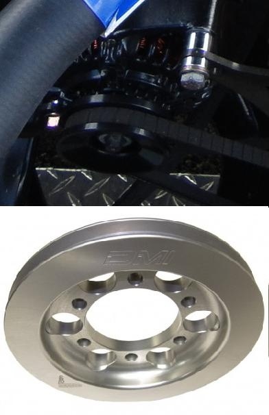

Mike, I'm running about the same setup, crank & alt only. I have a Powermaster 1 wire alternator with their deep grove pulley and a Doty/DMI deep pulley (5.75 inch diameter) on the crank. I can't remember exactly but my combination gives me about a 2.X pulley ratio which is recommended for not over spinning the alt. Works great, no problems.

I bought both pulleys direct from the mfg.
Powermaster - I've had great customer service with them. Give them a call direct. Measure your alt shaft diameter first and your existing crank pulley diameter if your going to keep using it.
Doty/DMI - They make great stuff. https://www.dotymi.com/
