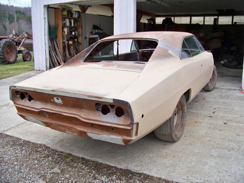

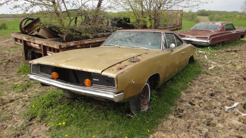

Parts car eh? Why not put up a picture and see how many people try to convince to that it's restorable. :)
Looks way better in pics. Rear springs are touching the top of trunk.

Glad you were able to get it open. Why do the pictures always look better?

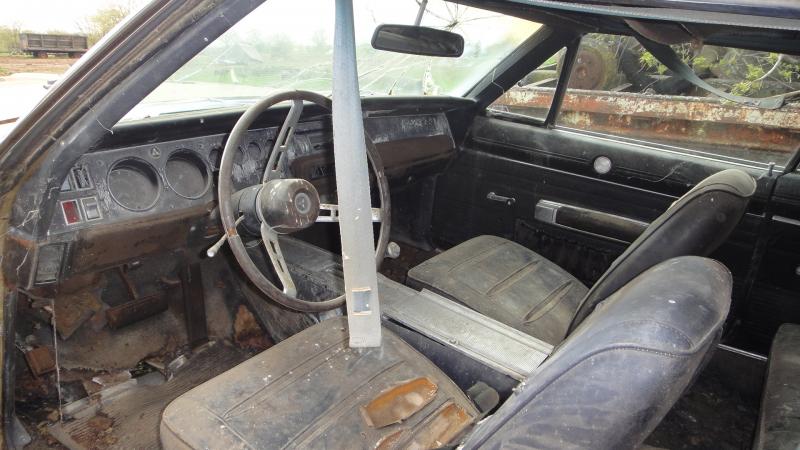

It is hard to tell by those photos if that car is 'restorable' (looks like it may have been rear-ended?). I do see LOTS of usable/ sellable parts: wiper arms (& wiper linkage under dash), front bumper, steering wheel, gauge cluster, console, seats, glass,steering box, headlight covers, steering column,...I could go on.

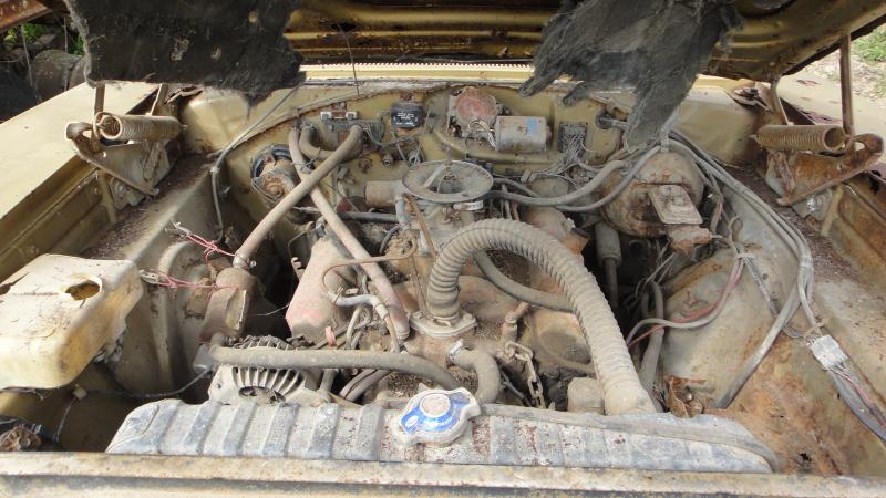

Is that a 'torque chain' on the driver side of that 318 with 2bbl? Lol!

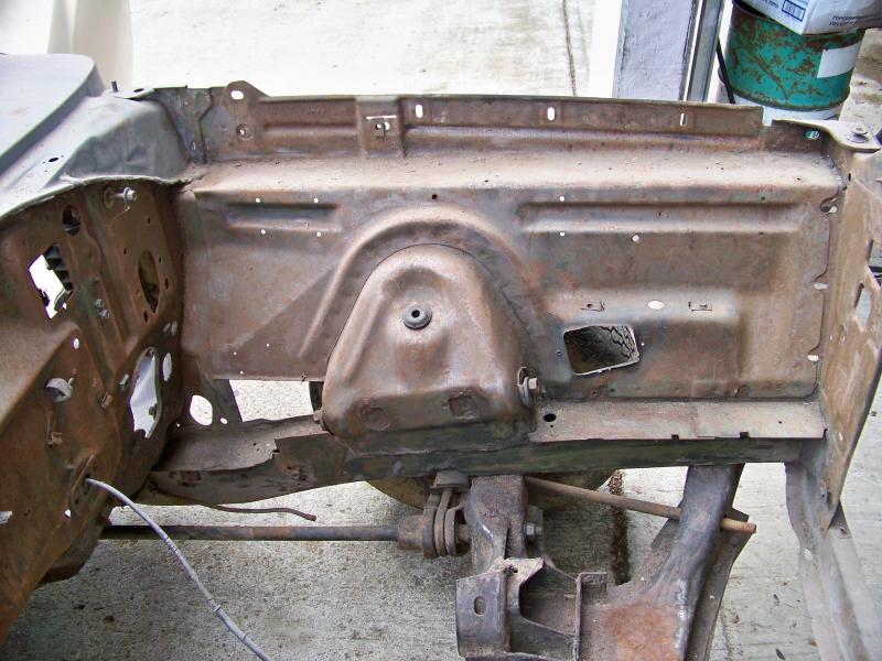

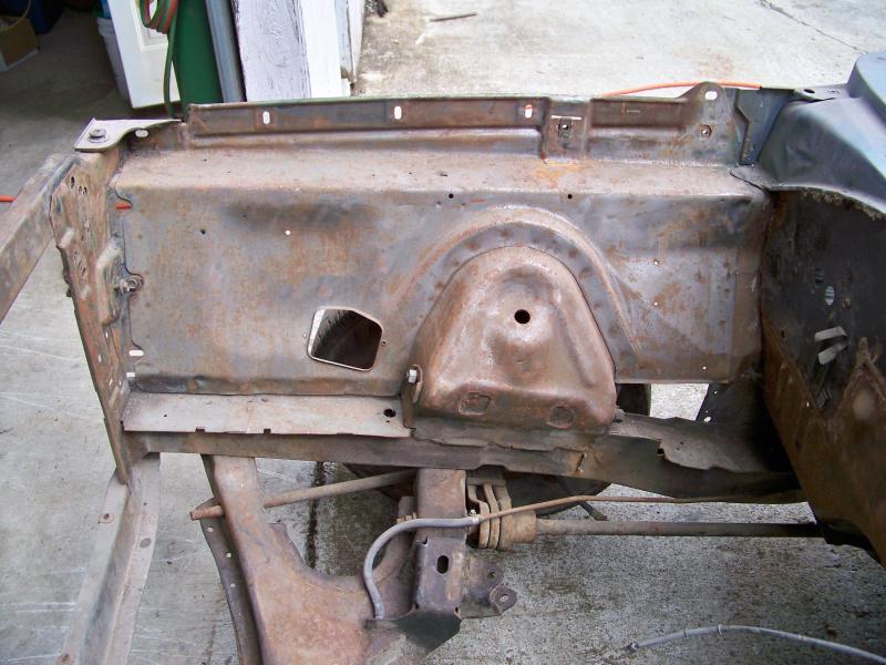

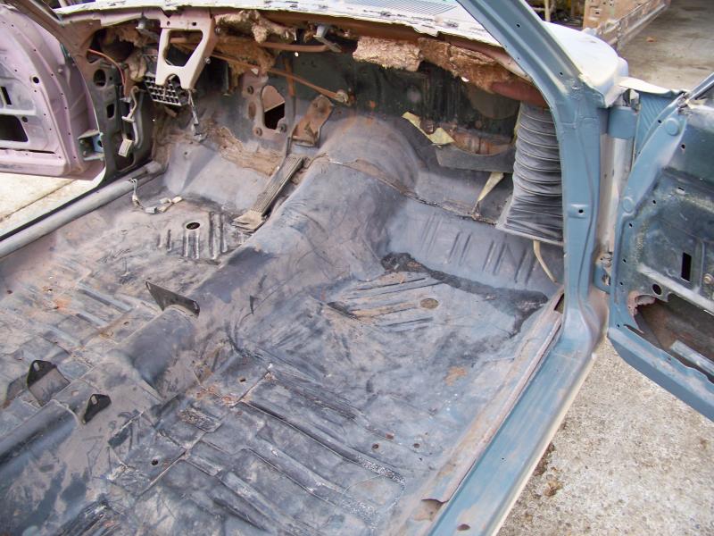

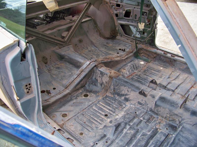

100_1765.jpg100_1756.jpg100_1757.jpg100_1751.jpg100_1752.jpg100_1765.jpg100_1756.jpg100_1757.jpg100_1751.jpg100_1752.jpgAlready got the parts covered. Bought this to hang the parts on.
