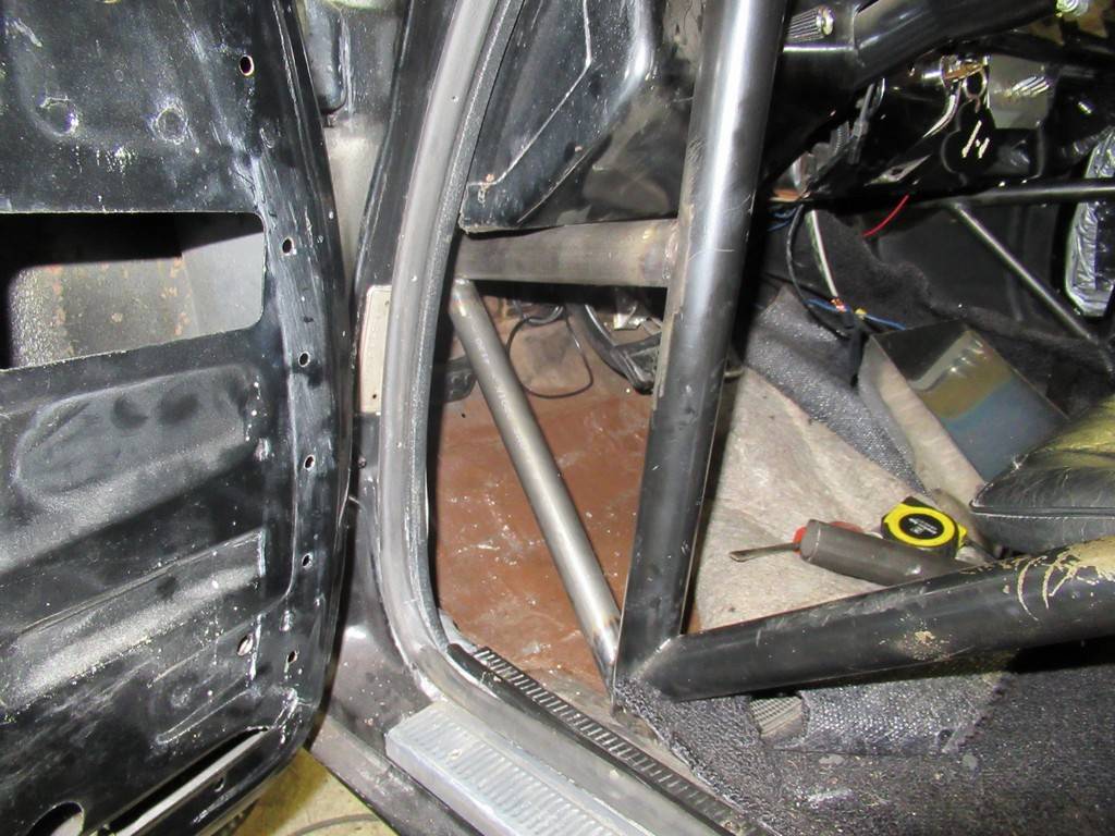

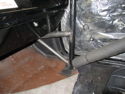

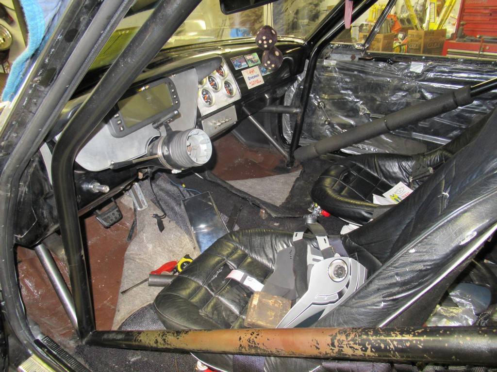

Get a roll of plastic and cut to fit:thumbsup:
You HAVE to direct the water 'away' from the inner doors from coming into the car. The factory used plastic sheeting and it was laid in to channel any water from going into the car. Think about how shingles of a house works....same principle.
Got it. So how was the plastic secured at the top of the door and inside where the glass is?
Good pic on post #422 but I like to only use a few dabs of the sealer at the bottom to hold the plastic in place....but only at the bottom. So, if water does get to the plastic, it can drain into the rocker area and exit out of the weep holes. Just make sure the plastic goes into the slot at the bottom.
