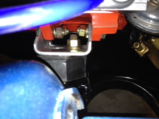

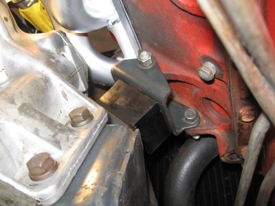

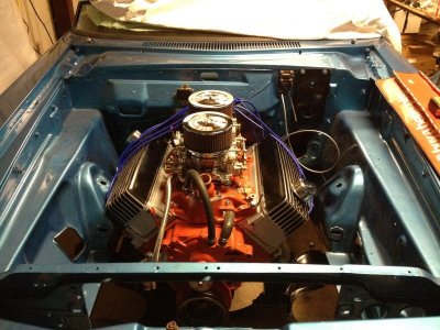

I can't remember how these came out, It was only like 6 years ago, but anyway. This is a 65 Coronet 318 poly. Do the mounts look right. I had them in 3 different ways. This looks the best. What do you think? They are not tight yet so I don't need you to tell me that.....Thanks!

Looks to me that the isolators (the rubber or poly part) needs to be swapped to the other side, pass. side needs to go on the drivers side.

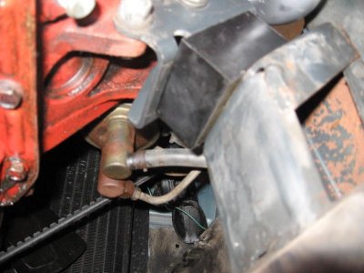

New pic

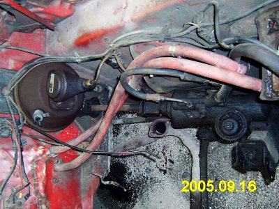

I found an old pic from when I pulled the engine. It was 7 years ago. It looks like the rubber is upside down from how it came out. The notch is down in this photo. The part number 2227 says drivers side so thats where I put it. The new ones look identicle t the old ones.
Oh yeah, I do like showing off the Poly!....lol

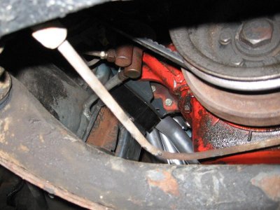

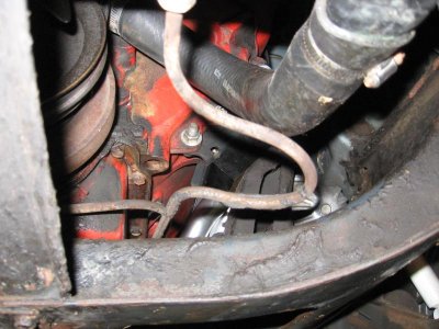

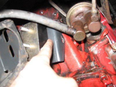

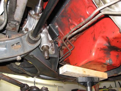

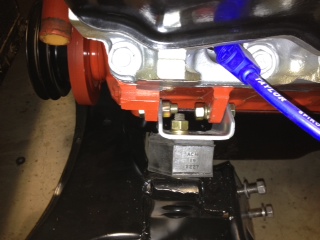

Hope these help. 64 Poly Belvedere

Two more.......

Thanks for the pic's.........I swithced sides and it seems to line up better. The trans was about 3/4" to far forward to the mount and it lines up better and looks straight so I guess I'll leave them. I guess if it all lines up it wont be a problem.
