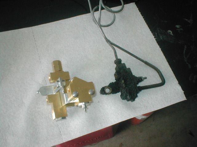

help with this porportioning valve
70RR2GO
7:31 PM
Jul 31, 2013
69
7
ca
This is the one I purchased for my 70 roadrunner that had drum on the front. I see a lot of people selling this one for the front disc conversion. Looking to see if anyone has a picture of their install with this type on can point me to a picture or sketch. Thanks for any help. The ugly one was off the car with the old drum set up.
The picture looks like this one available at inline tube, http://inlinetube.com/Prop Valves/BLK247.htm, except for the placement of the two valves. If the same, they have instructions on how to hook up. A front disc conversion needs a combination valve that includes a proportioning valve to the rears, a metering (or hold off) valve to the front, ideally a residual pressure valve (often part of the master cylinder) to the drums, and the pressure differential switch (which illuminates the instrument panel brake warning light). The old one is a simple drum/drum distribution block with a pressure differential switch.
