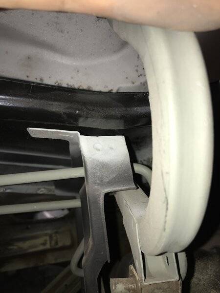

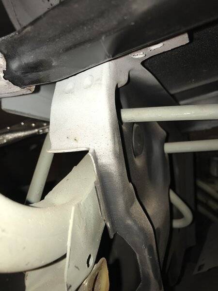

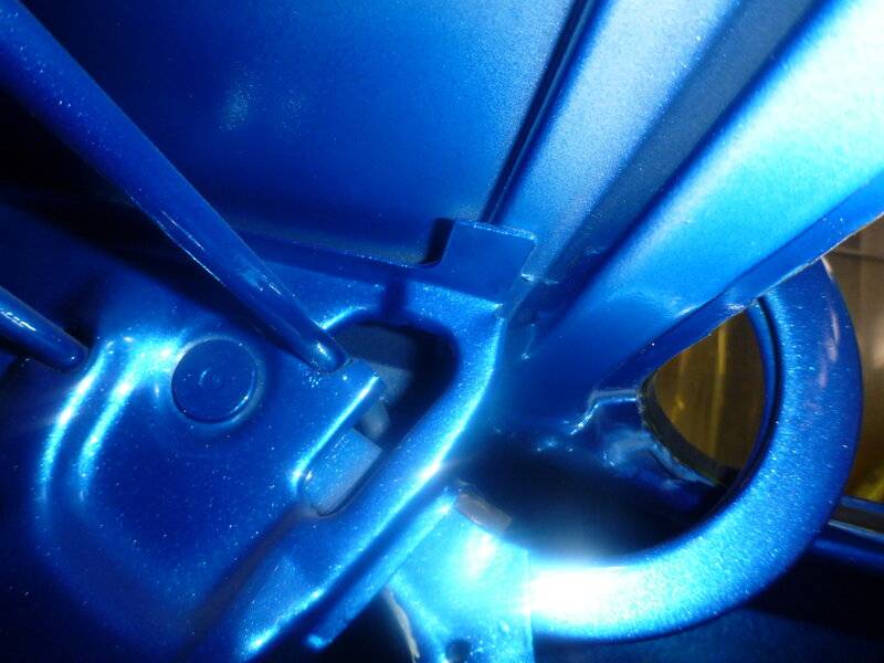

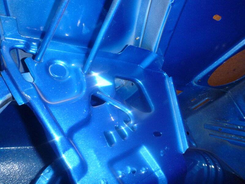

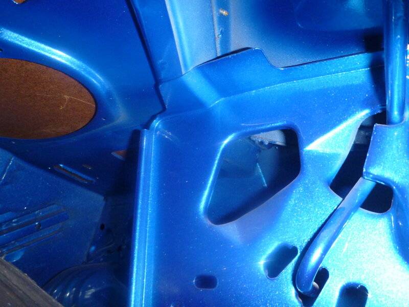

I had to cut my old supports out and replace them with a set of used ones along with the Dutchman panel. They are tacked in right now but looks like I need to adjust the rear part on both. Can someone take and post a pic Of theirs please?
PM'd you , but in case anyone searches in the years to come. Looks like two spot welds at the rear joint and one at the front. Barely visible and you'd almost think the front isn't even welded.
