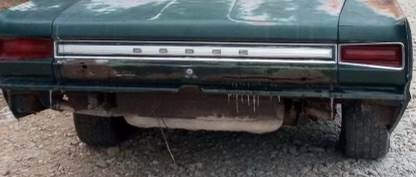

Will 1968 rear frame rails from a b body work on a 1967 dodge coronet as you see back bumper gone and only way to secure bumper is to replace rear frame rails and I am doing a full restoration on car and the no way in hell I gonna settle for rail caps

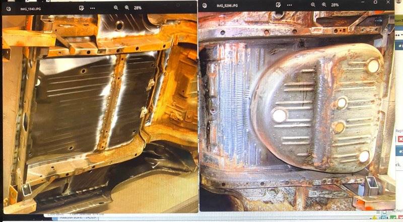

Here is a side by side comparison between a '70 b body (on the left) and '66 (on the right). There are a few minor differences (holes) but I think they are basically the same due to 66-70 b bodies being the same platform. You can cut and section a piece in if need be, that's what I did on the '70. I hope this helps.
