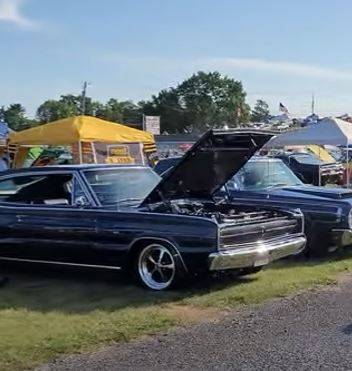

go to 50:34 and check out the wheels on the blue Charger. Can someone tell me what size and make they are please. Thanks!
This wheel?
Looks like Year One's 17" Magnum Wheel https://www.yearone.com/Catalog/wheels/wheels/yearone-magnum-wheels/mopar-magnum-wheels
I think American Racing makes some as do others. Look like 17s
Yeah I also wondered if he meant the Gen 1 or the Gen 2 Charger. I'd agree the Gen 1 looks like it is wearing the Year One 17" shoes. Actually pondering a set of those myself for the Satellite.

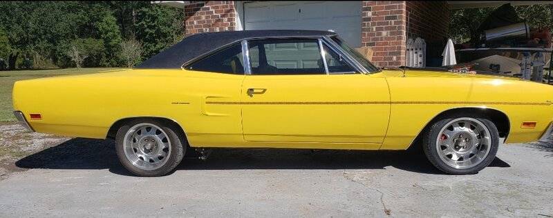

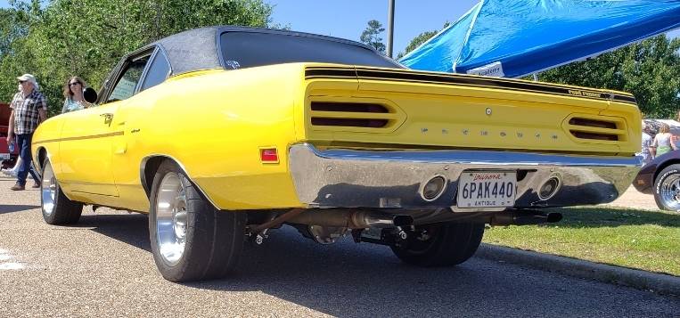

I'll add that the quality and appearance, as well as the backspacing of the (front) 8" W x17" dia. @ 4½" backspacing and rear 9" Wx17" dia. @ 5" backspacing REALLY fit well all around on my 70 Roadrunner. The factory-like fit, EVERY dimension you would think of, of a pair of Toyo Proxes TQ drag radials on what was a bone stock rear suspension was, well, "it could have been factory equipment" perfection!
Kudos to Year One for their Rallye and Magnum 17" wheels.
I have a pic somewhere of the factory Rallye steel wheel and one new Y1 aluminum Rallye installed, and man! They REALLY hit the mark for factory style appearance.
I know you are referring to a Magnum look, I am mainly commenting on the fit and quality.

My buddy has a set of those on his '71 Duster 340 and they look stunning.
