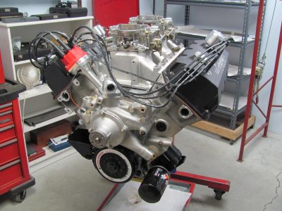

Mild 11:1 572 on 91 octane. 723 LB-FT and 781 HP.
