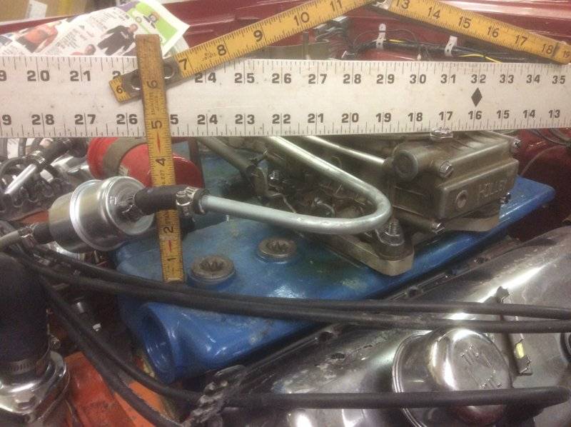

I need the height from bottom of carbs to the block id pad. I've seen these intakes on a 66-67 Belvedere and wondered how much hood clearance was there. Or did it need the RO scoop?

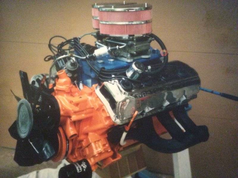

Had one on my 66 Satellite but cut hood for air filters. You would need a crossram air cleaner.

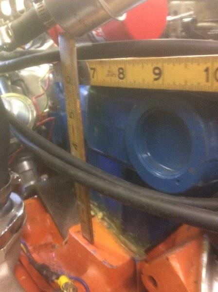

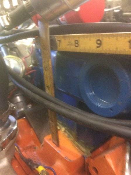

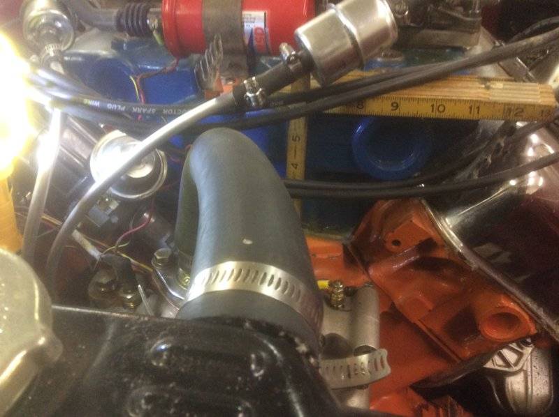

Fresh pictures. Didn't take photo of pad to top of carb driver side, it is 10" off pad. Back of manifold is higher, guesstament 3/4". Pad to top of driver's side is 5 5/8" to 5 3/4". Photo 2 and 3 are the same just turned. A soppy job. If you use xram with bolt on top its higher.
I have nothing to do with this but, Fran your the man! Great pictures. Thanks for the effort!:thumbsup:
Fresh pictures. Didn't take photo of pad to top of carb driver side, it is 10" off pad. Back of manifold is higher, guesstament 3/4". Pad to top of driver's side is 5 5/8" to 5 3/4". Photo 2 and 3 are the same just turned. A soppy job. If you use xram with bolt on top its higher.View attachment 811582 View attachment 811583 View attachment 811584 View attachment 811585
Thanks, I have a Hogan’s cross ram fabricated one, 8-1/2 to top, I guess a big hole in hood with a spacer under scoop to raise it up some to fit some shorty aircleaners
