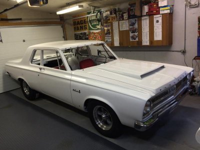

On my Belvedere, the scoop is centered on the hood left to right, and about 1/4" from the rear edge of the hood.

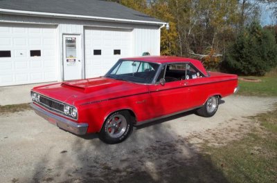

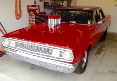

I put mine flush with the rear edge of the hood6497C2A6-DDB5-46F9-96C4-30C358C6CBB3.jpg

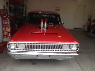

I have done some mods on my RO scoop and the placement for me is what fits my eye which is approx. 1 1/2" - 1 3/4" of the back of the hood(behind the green door build)!!!
Gary

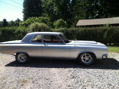

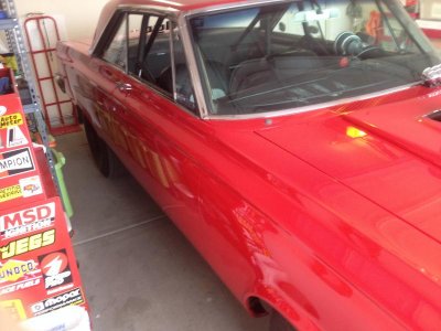

I put mine approximately one inch from the rear of the hood. Haven't figured out how to post a photo here, I'll forward one as soon as I can.
Thanks for the info and pic, great looking car!

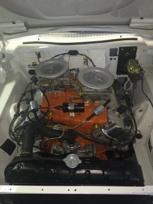

Here is a walk around video of the 64-65 steel hood on my Plymouth Belvedere. The 2nd shot shows the correct cutout for the air cleaner .[video=youtube;-H7GDrd_o58]https://www.youtube.com/watch?v=-H7GDrd_o58[/video]DSCN0215.jpg

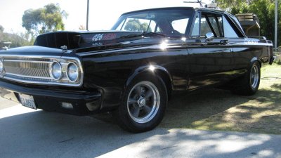

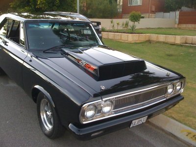

Sorry about multiple pics, this is how I placed mine--one inch more of less from end of hood.
