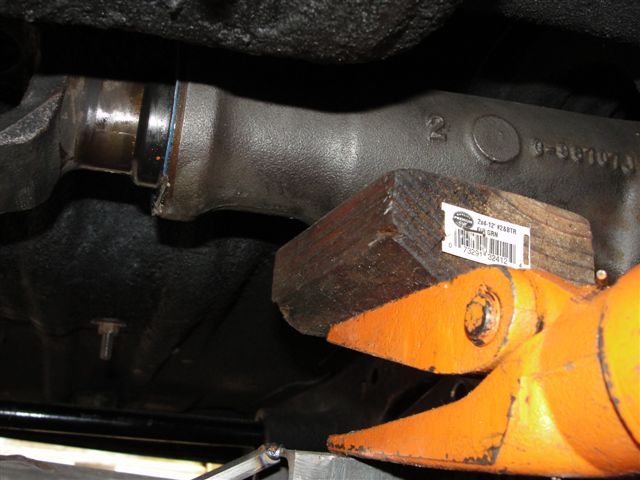

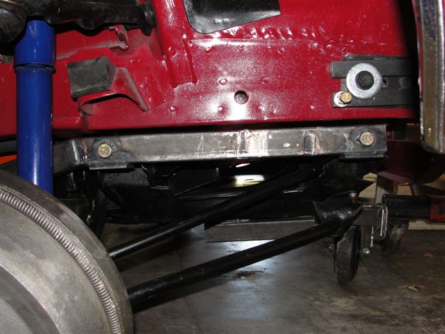

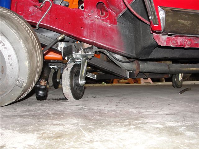

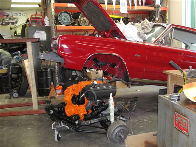

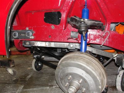

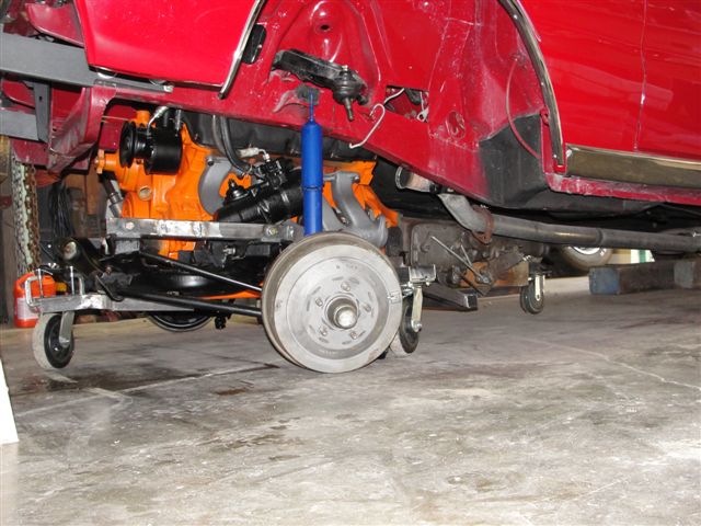

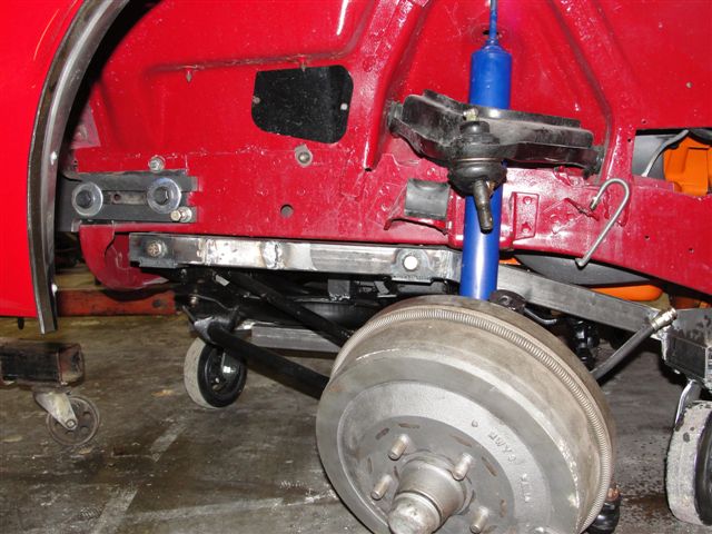

So I made this body lifting fixture and a cart to hold the K member with the engine and tranny installed and it worked great! Only hang up was making clearance to get the cross member in but otherwise it couldn't have been a better fit, and I didn't need a saw to remove the cart once the K was bolted up! Whew! You will notice the angle of the cart frame vs. the car sub frame is almost exact when I set the body down to the limit of the engine crane. This is not by accident and the result was an easy start to all four K member bolts. I did the whole job myself and it took about an hour, which included having to remove the steering column and fighting with the tail shaft. I may lower the rear part of the cart to aid in cross member installation but other than that I'm very pleased.

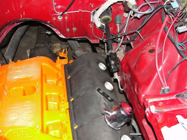

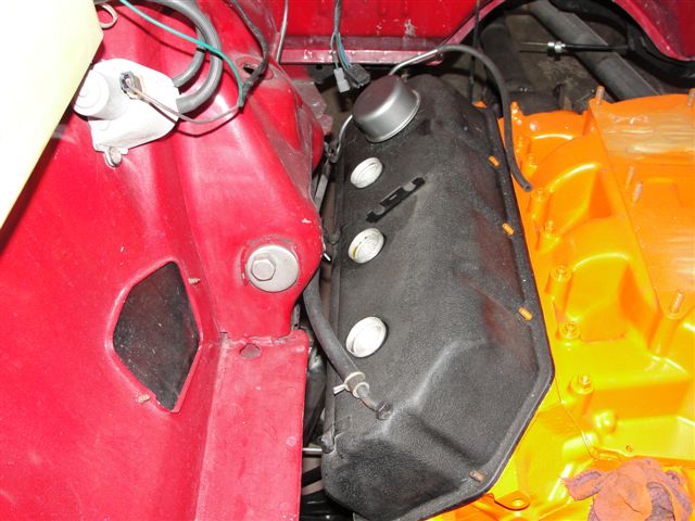

More pics of the install.

Once you do it that way you will never do one from the top again. You don't have to worry about working over fenders or scratching up a freshly painted engine compartment.
