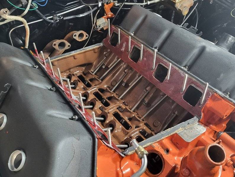

Putting my intake back on ( yes I switched to all studs ).
A- that way it goes straight down.
B- its easier to torque them accurately.
Is it OK to follow OEM specs / values .
Plus , this way I have close to if not a full inch of thread engagement in the heads . I cut them all from a longer piece of 1/4-20 all thread
72inlbs center
48lnlbs outers

Ive got them torqued down and have gone over them at least 5 or 6 times so far. Feels like they are settling in.
Once its gone thru a few heat cycles. I'll go over them all again.
I realize the studs aint oem. But I dont care . Im more concerned with getting them all torqued as they should. The OEM hardware will go in the tool box for another day
All the nuts are new and with nice plating. . It looks good, Just not dead nuts OEM.
The final deciding factor to go all studs was no one local had the right Allen socket in 3/8" drive. And I wasn't buying another set to just get the one I needed.
All I had was one of those flip open Allen wrench sets. ( no idea where mine went )
The material to make the studs were less than $10 total and I already had the captive washer nuts on hand from my vendor days.
I left the carbs off and let the gaskets consolidate for several days, re-torquing several times during the day and then a couple of times after installing the carbs and starting it up. Some of the bolts/ nuts are a bit hard to get to with a torque wrench with the carbs on. No idea how many times I re-torqued but probably more than a dozen. The Mancini bolt kit (reproduction) I used had 6 threaded studs and the rest bolts.
I have used OEM bolts in the past. I also stud mine as well. I never cared about 100% correct. Sometimes with 60 year old heads and sometimes even bolts. I have pulled threads before and had to helicoil before. Studs are nice with aluminum heads as well.
