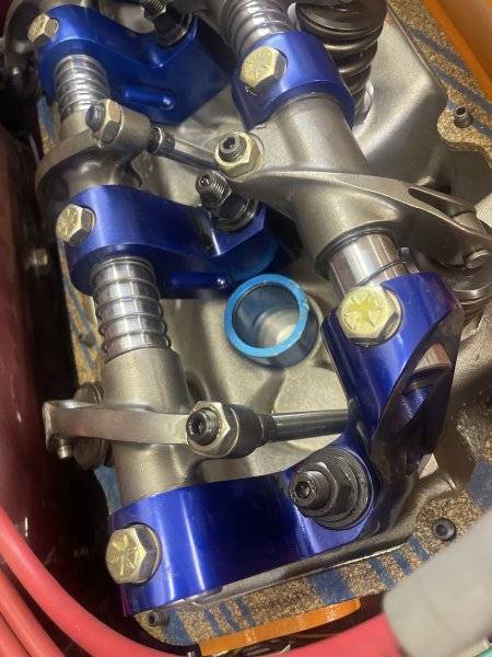

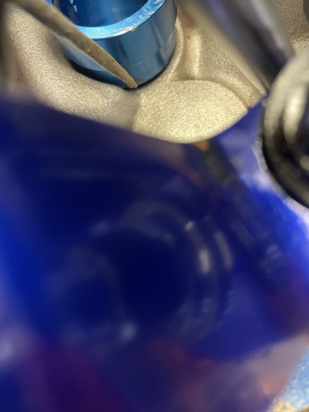

A little help needed here. I am installing the Milodon tube seals in my mopar Hemi performance heads. It looks like the heads are not machined (open) enough for the step in the blue seal tube. I would think step in the tube would sit flush on the head. Any recommendations
I took some pictures, not the easiest to get a good one. But I think the last one show what’s happening.
Thanks
I took the tube out and you can see where it’s hitting. I don’t think these are usable unless I am machine them down.
You are correct, that is not how the factory iron heads are. I have the Milodon tube seals just like your and did not have any issue installing.
I just read that the Mopar performance aluminum heads, and the Edelbrock heads are not machined in that area so they can’t be used.
Thanks
Thanks
Let me know if your not going to do the machining if they are for sale
Those tubes stay above the head to prevent oil from going into the plug opening. Without them when you pull the plugs and start the engine you'll be blowing out a lot of blue smoke. I did mine 21 years ago and don't remember having a problem, but I have stock cast iron heads on a 472. I don't even know if they were stepped like that.
