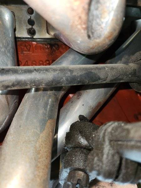

Based on the pad and numbers does this look like a factory 426 block..thanks
Numbers need contrast can't read. I lean not a car installed. Maybe a warranty block or Mopa Performance block. MO
I'll see if I can get better pic tomorrow. I do see where it says
G21 ,15. 566 and that's upside down
Also the pan rail # by the bellhousing would be nice.
Think it says 246833-M
The heads have a mopar emblem as well.
Mopar Performance block? Think your missing/can't see one number should be 7 digits.
Are those good blocks
Oh yeah, highly sought after just like mine that was drilled for wedge heads. Remanufactured from 1996-2006. better than the original hemi blocks and head and shoulders above the wedge blocks, weighs 80lbs more than a 1970 440 block. if u open it up u will see the differances.
mopar mega block
