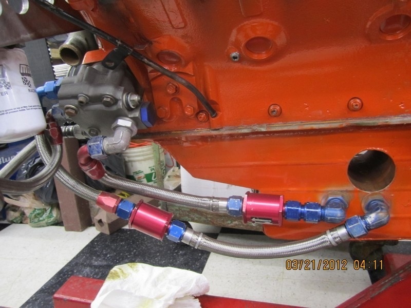

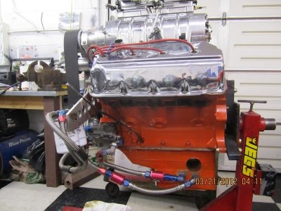

I use mopar orange. With a fresh build, I use etching-primer on the bare metal....then apply the orange. All my go-fast stuff is gloss-black.

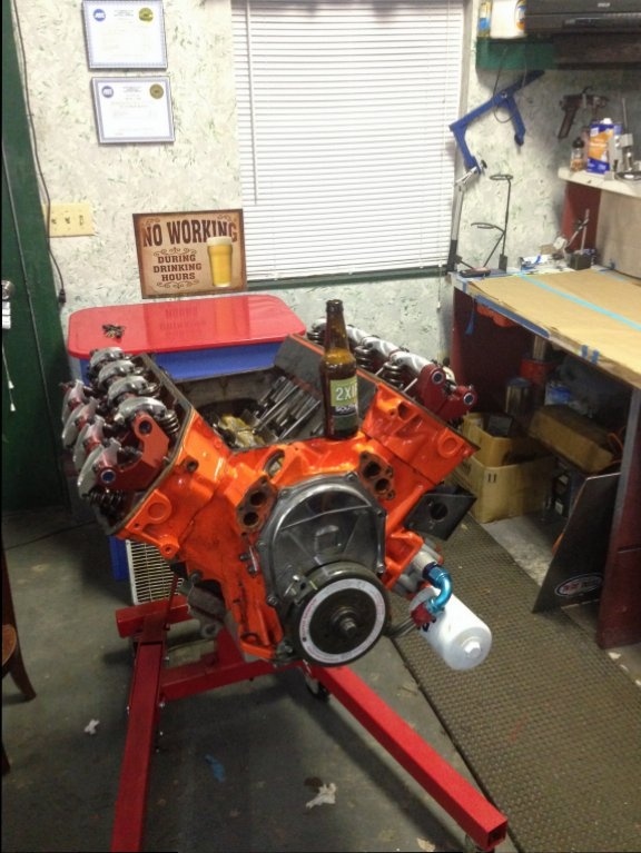

Red
I used Eastwood (w a gun) on this one, although it was a bit thin. I would primer it first before I did it again.
The hemi I did with allis chalmers rustoleum (spray can). Looked really good and held up very well. It's dirty here but just came out of the car after several years. Rustoleum also makes a hemi orange but it doesn't look to be formulated as good as the chalmers orange.
