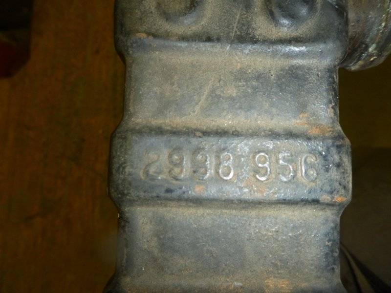

LOL.. shat happens! Like I said we can't help him without a car year. 70 and if he wants to go 26" is the same for 383/440 and Hemi. A 956 radiator..

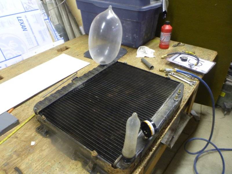

I like your method to check for leaks, but how much PSI can those things hold?
Also, why do you have them, aren’t you beyond the age of having to worry about getting the missus pregnant?

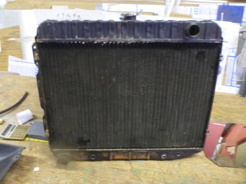

2898047 passenger side inlet, driver side outlet.
2898047 1968 B 26 440 MANL HTR WITH 492
2898047 1968 B 26 383 440 AUTO A/C
