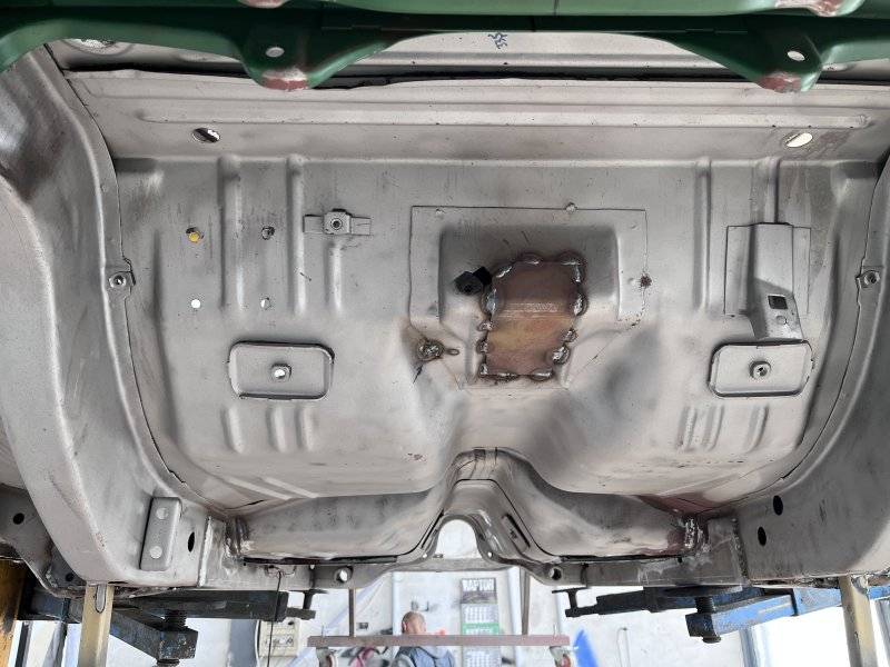

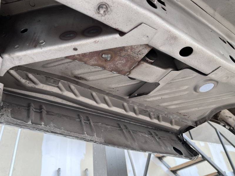

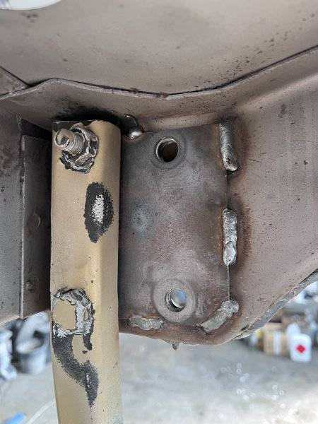

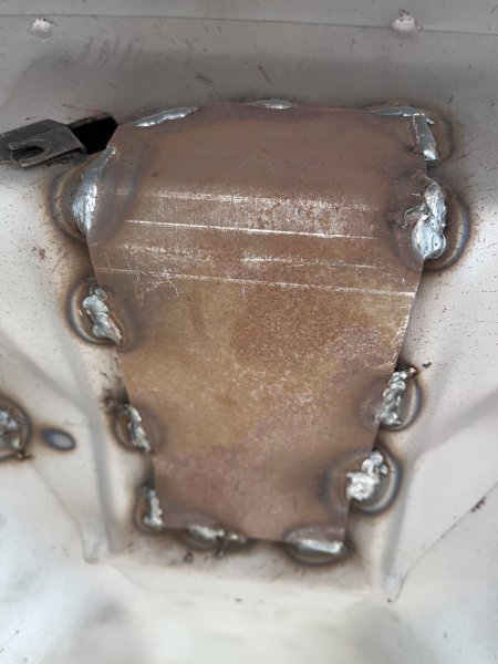

For information only: I had purchased reinforcement kit for factory Hemi from guy, quality is top, but a bit expensive. My Bodyshop-worker has welded all plates on my 68 Coronet R/T and all is good matching. No issues. I will show pictures
