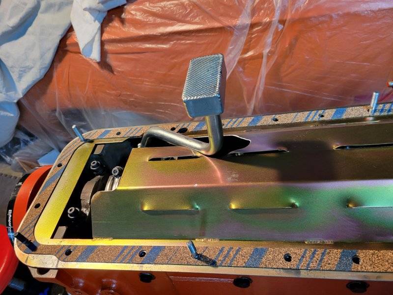

What would be an acceptable sealant to lock the screw in oil pick up tube? Mine is not tight when it is in its proper location. Going another 330 degrees around isn't really going to work either, well, it could, but, the short block assembly, timing cover and water pump housing are all in. Tried a 1/2" pipe die, doesn't seem to be moving the meter much. I suppose I could try running a tap deeper, trying to be careful about shavings with grease. Still would have to clean it. JB Weld? Red Locktite?

Had the neighbor over for hot dogs over an open fire tonight. Damned if he didn't have a new set of Rigid pipe thread dies and the wrench rachet. I have the pickup in now, but it's very lop sided. I need to correct it 1/4" from side to side off the floor of the pan. It's off about 1/2", now. Must have always been off some. Looking for 1/8" to 1/4" off the bottom?
