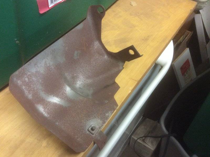

Good morning all. Looking for some insight and help on installing the hemi starter shield in an 70 auto transmission b body. Wasn't to much fun taking it out to have the starter rebuilt. Just looking for help on the re-install. Thanks.

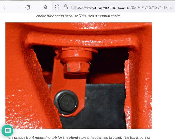

The picture shows that the tab goes to a exhaust manifold bolt. Shouldn't be to figure out which one.
Having just put a new battery cable on mine.*( not fun btw ) How the heck you even get the shield in there with the manifold in place
