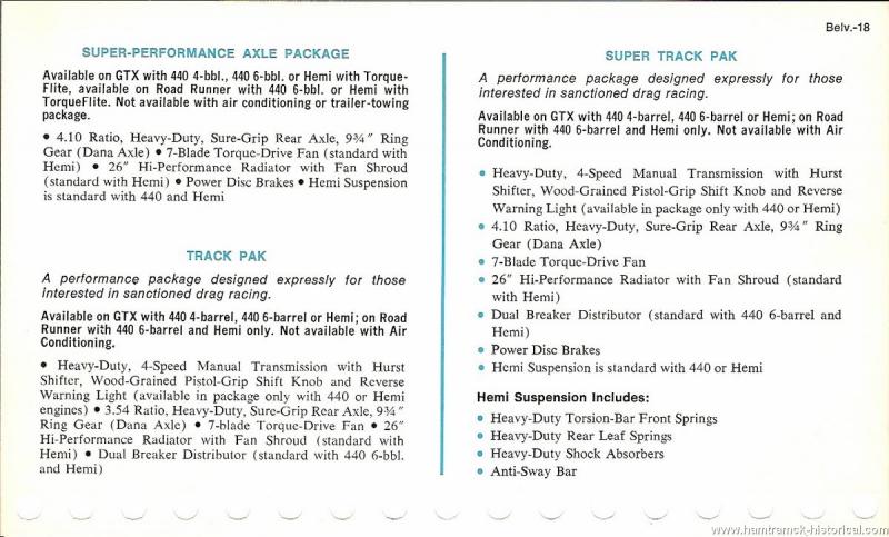

If you ordered the Hemi suspension on a 70 RR what was the difference between it and the normal HD suspension a 383 road runner would come with? How can you tell if hemi suspension has been added, or was installed on a 70 Roadrunner. I have extra leaf springs, but was there a larger Front Torsion bars used? What about sway bar? Specific measurements I should look for? Thanks, G
Look at the bottom right of the pic and you shall have part of your answer.
Thank you, I have seen that info, unfortunately it doesn't really answer the question because RR came with those components. I am trying to find out the difference between a RR HD Torsion Bar and a Hemi version. Same with sway bar. I am assuming thickness, but not sure. G
The 383 4bbl is .900,the Hemi bar is .920,sway bar is the same.
