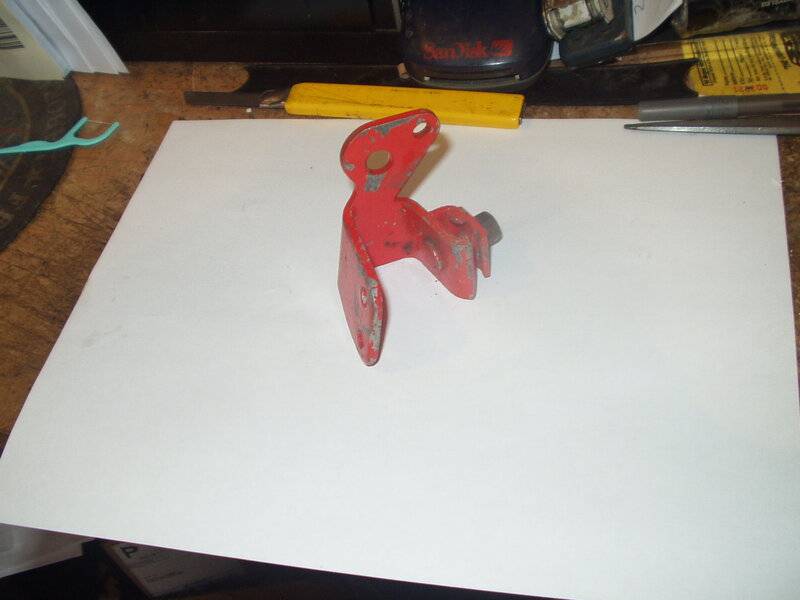

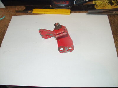

I need a stock 66-67 Hemi 4-speed throttle bracket. Anyone have a spare, or no longer need? I found automatic transmission replacements at Mancini, but I need one without the kick down.
Just knock the pivot pin for the lockdown lever out of the bracket they are just pressed fit
The stock bracket does not have the appendage for the kick down, but I guess it could be cut off. I will address that option if I can't find an original. Thanks for the input.

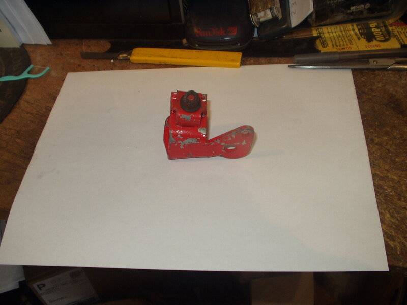

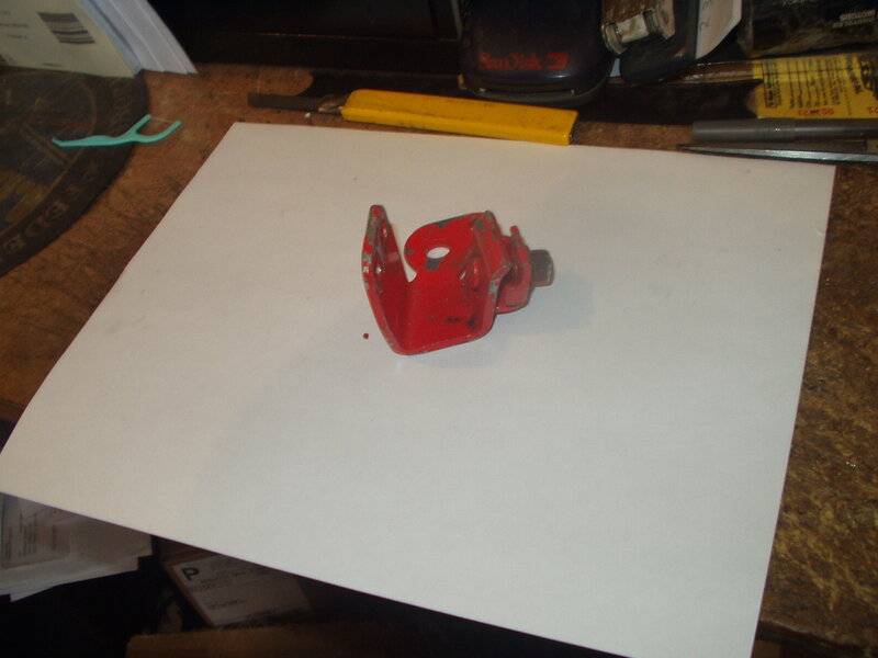

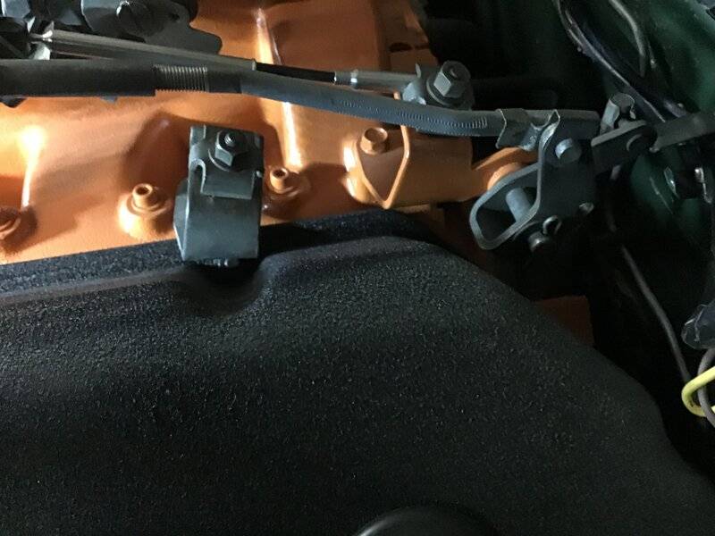

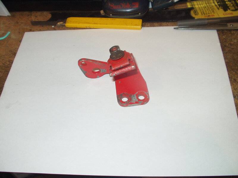

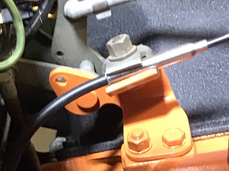

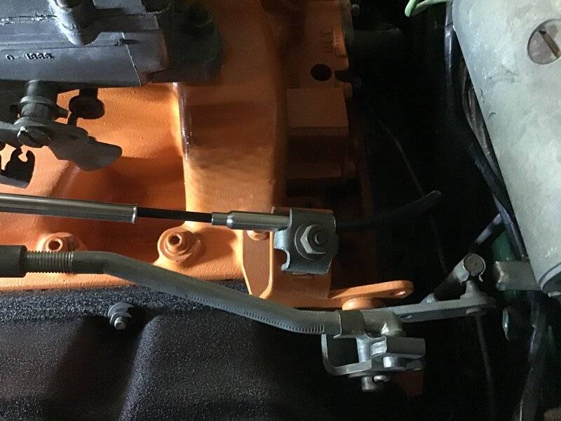

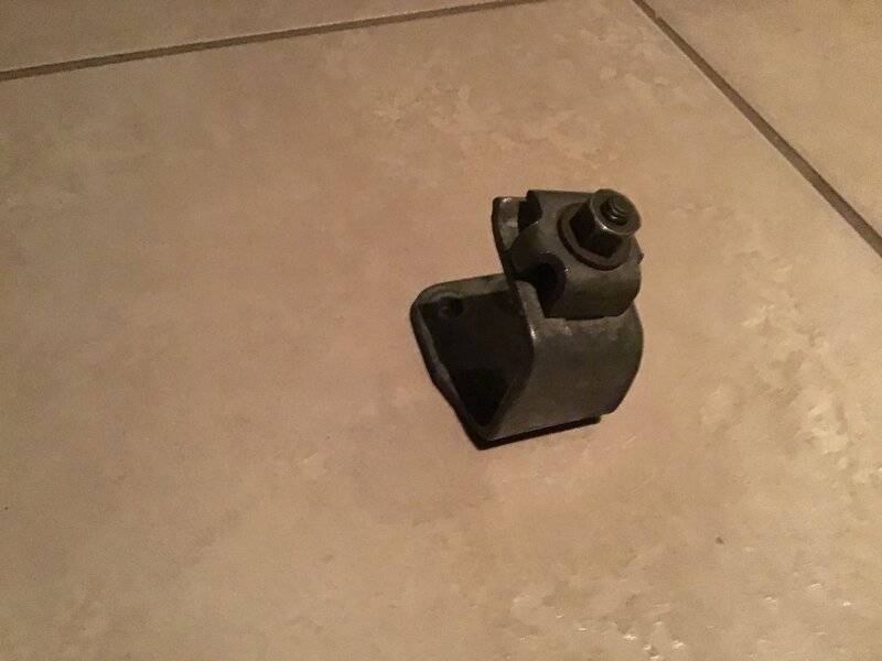

Check these photos of Auto and a manual throttle cable bracket. Like Jerry said, the auto has extra material for the pivot pin mount. Not present on the 4 speed bracket. Not reproduced either. That’s strange.

As usual when I was trying to correct or find errors on my Hemi cars I didn't have a smartphone or camera. Thanks @R413 for the pictures.
The story, I picked up my car from a carburetor and tune up man that has done (trusted) work for me for 50 years. I took it to him as it wouldn't idle without holding the gas down a little. It used a little less than a 1/4 tank of fuel going. He rebuilt both carbs and it idled great. I had about a half of tank of fuel when I got it back. On the ride back home, I thought there must be a fuel leak because I was beginning to pray that I had enough fuel to get back. Inspection today revealed that he had put a shim in the linkage that let the front carburetor add fuel at idle. This also locked the linkage so that the car was running on both carburetors full time. I corrected the linkage and back to no idle. Futher searching revealed that the vacuum line from the distributor to the rear carb was split almost at the distributor. I replace the vacuum hose and bingo, it idles great. I had a friend in the car after I shut it down so that I could check for wide open throttle as everything had been torn down for the rebuild of the carburetors. That's when I noticed movement in the throttle bracket. Then I noticed that it was basically homemade. Although I have everything now working properly I now want the correct bracket. I now have carburetors rebuilt that may or may not have needed attention to the tune of $480 for 50 cents worth of vacuum hose.
That's for an automatic. He's looking for a 4 gear bracket.. "but will cut off the extra if necessary".
Had one like Bob's came off a 68 GTX 4 speed engine, no pin but had the extra metal for pin.
