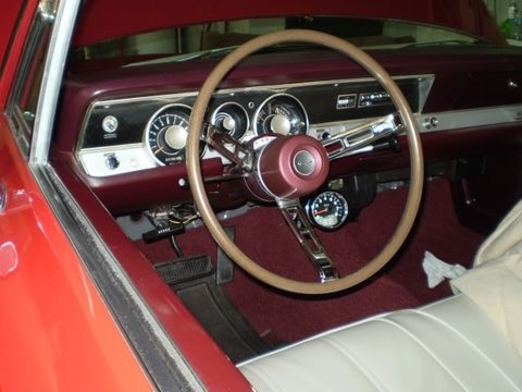

Hi everyone,
I am getting ready to spray my interior vinyl dash pad, glove box, and plastic trim pieces.
What is the proper way to prep these pieces. I washed the pieces with dawn dish soap twice. I was going to use sem plastic cleaner and then bulldog adhesion promoter before painting.
How should I prep the vinyl after washing it with dawn soap? Does it need any bulldog? Should I use acetone or Sem vinyl cleaner? If anyone has used Herbs Paints please let me know the best method. Thanks
