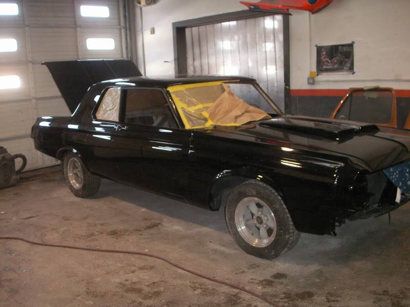

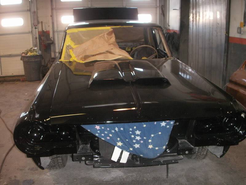

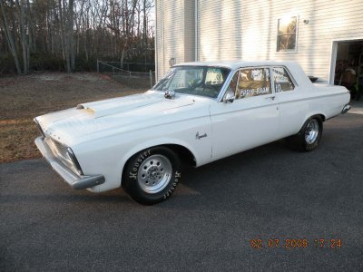

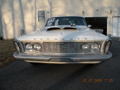

Here's a couple of shots of the car. A few more details and I'll be taking her back home.

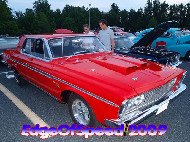

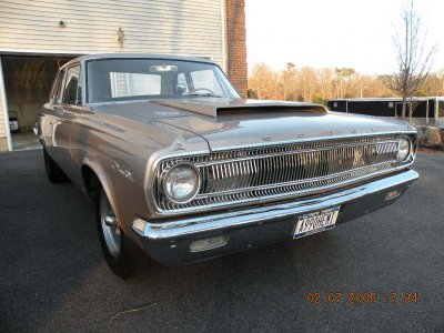

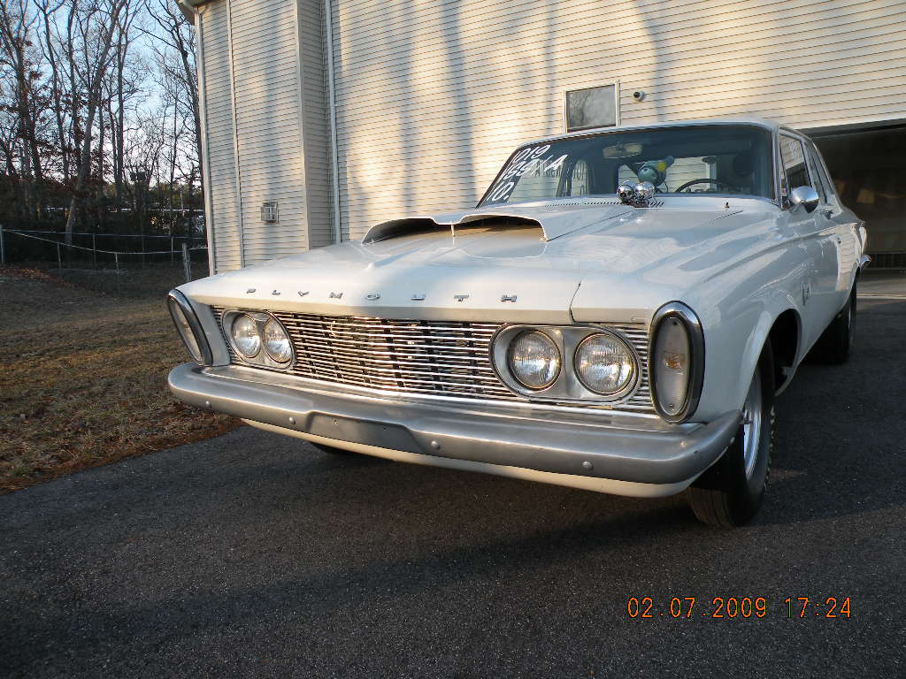

joe, you wont have any problem as long as it stays tight against the hood.

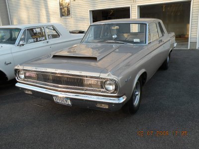

thats a max wedge scoop, different than a race hemi scoop. heres mine for comparison and illustration.

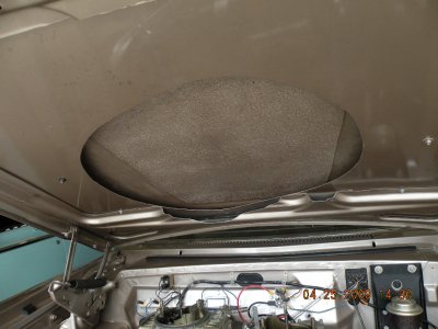

So do most of the guys that put them on make them functional?Or no holes and just for looks?I like to drive stuff rain or shine,pretty big opening and looks like it would scoop the rain as well as air.
mine are totally functional. why put on the scoop if your not going to make it work.
how many times do you drive it when its raining ?

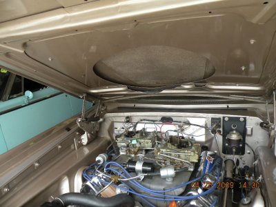

heres a pic under side
