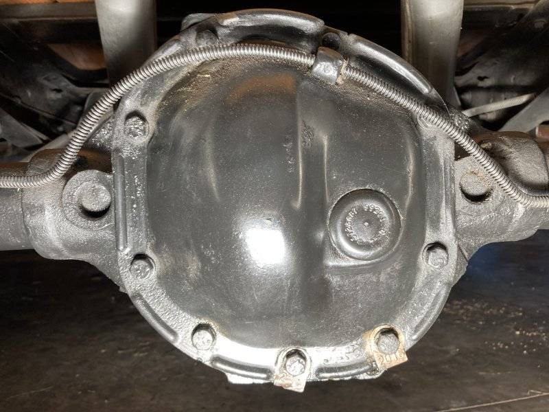

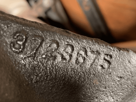

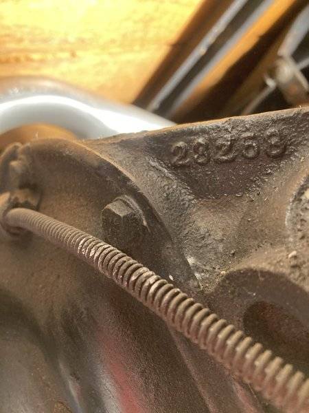

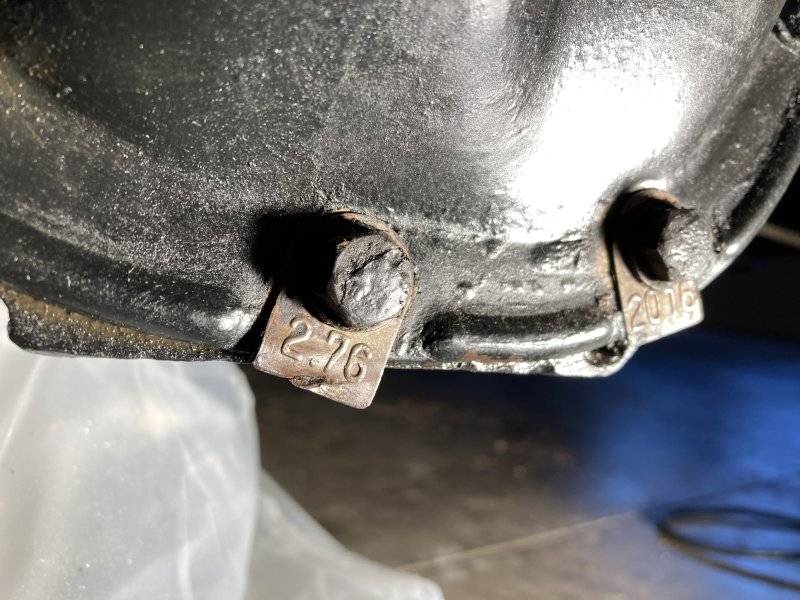

I am hoping I can get some help on what I am told may be a Dana 44 differential which is currently installed in a 56 Ford F100 and I have no history on the build. My attempts to identify on line have been unsuccessful, but I did learn that Mopar did use Dana's with 2.76 ratios, so maybe the donor was a Mopar somewhere along the line? The cover has 9 bolts, not 10. The numbers 3723675 are cast at the upper rear on the driver side and 23258 or maybe it's 28258 appear at the upper passenger side. Two metal tags are at the bottom, one read 2.76 and next to that is a tag with 2016. Thanks VERY much for any help you can offer. I would like to add posi-traction to this differential so any advice on that would be a definite bonus. Thanks again.

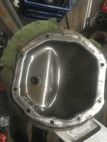

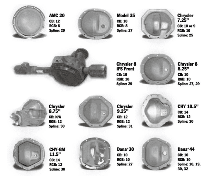

kinda looks like a Borg Warner 9 bolt rear but not sure
Maybe the design changed from back whenever this differential was manufactured? It's close to the picture you sent, but not exact and the 9 bolt instead of 10 bolt is confusing me. The Chrysler 7.25" at the top of the chart is actually closer and apparently was made with either 9 or 10 bolts. I'm hoping I don't have some weird, off the wall rear end. Maybe more replies will clear it up! Thanks.
If it is the Borg Warner rear, it's also known as the M78. They were common in 3rd gen Iroc Camaros and Trans Ams, were a lot stronger than the old GM 10 bolt.
This is a 3rd gen. cover (inside view):
From FABO
7 ¼
Junk.read no more. Introduced in 1960; it was a low performance axle for /6 and small V8 cars. Before you swap this unit out put some slicks on your car..rev up the engine good and launch real hard a few dozen times. Or street race your car for a night or two, or objective here is to blow it up.
The rear end will eventually go KABOOM. Lots of fun for all….bring a tow strap so you can get home. Casting numbers # 2070051, 3507881, 3723675
Info: 1 3/8" Pinion stem, 9 bolt cover, 55.6" width (flange to flange) / 53.2" housing flange to flange / 43.02" spring seat centre to centre.
SPECIAL NOTE: The 7 ¼ housing axle tubes are smaller in diameter than other units so the u-bolts and spring plates are useless if converting to a larger axle (i.e. 7 1/4 to 8 1/4, 8 3/4 or bigger).

Do you have something like a pair of straight calipers that you could measure the OD of the ring gear? Get close and then measure the caliper tips with a tape or ruler.....if it's close to 7 1/4" then that's what it probably is but looks to me 1 Wild R/T already called it. Measure the diameter of the axle tubes and see if they are less than 3" in diameter.
