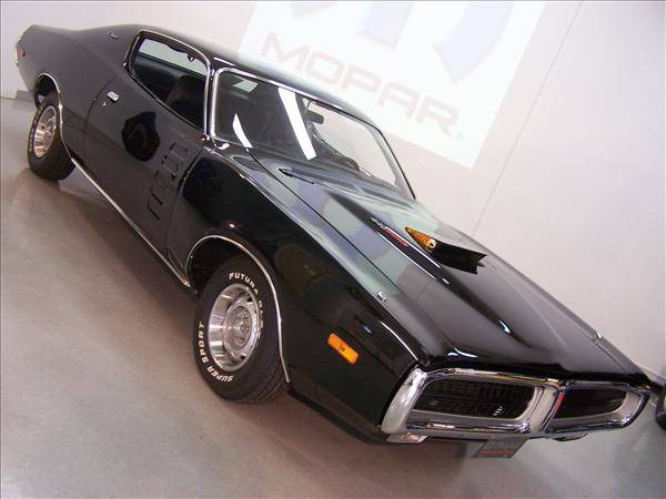

Am the proud owner of a 1972 Dodge Charger Rallye Coupe 440. Factory triple black finish, Believed to be a One Of One, Matching numbers. Mind you during the resto the vinyl roof was not put back nor the flat black hood or gills.

Have any pics of your Rally?
