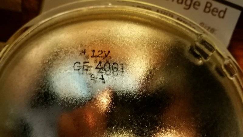

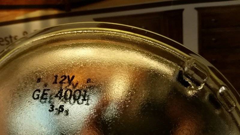

I still have my original GE 4001 high beams, but after the restoration I went with Sylvania Halogens all around, I don't drive much at night plus the car has all new wiring so not really worried about huge pull on the electrical system, and I am sure its not that much more anyway. I checked the 4001s today because you got me curious, and they still work and are still pretty bright, I am guessing they were put on sometime in the 80's so not the original assembly line bulbs, at least I don't think they are, don't know how you could even tell.
I am not sure on 80's bulbs but the older bulbs are dated on the backside in ink...
Interesting, so one is 9-5, the other is 3-4, those are the only codes, so I don't know if that's monthy-year, and if so what decade! LOL
In this modern day age of technology a picture would be helpful and easy to do.......

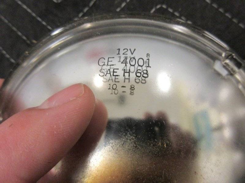

This is what I am referring to on early bulbs...below dated 10/68 h1968 the 80's are different it seems but with no pic, uhh
Like these, here are mine.
I had a dyslexic moment, 3-5 and 9-4, so then you are saying these are 70's era lamps??
Now we're talking, thanks for the pics......
Obviously, they are later bulbs and not pre 70....my guess is 80's.....You gave me something to research and I will get back to you......I have to narrow down when "SAE" was removed from the stamp.....

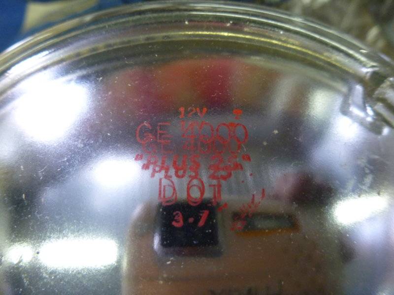

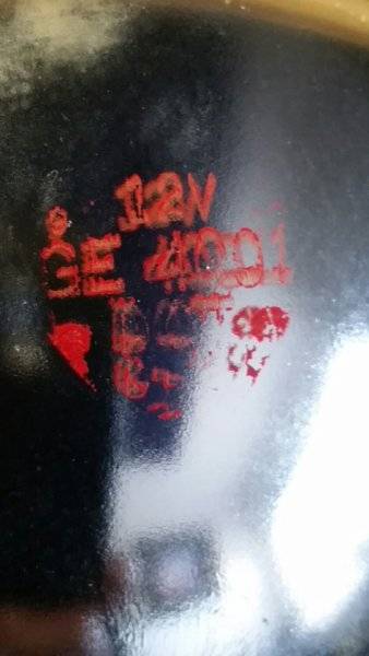

Here is one that is a bit more odd, unfortunately the ink is worn, but it has DOT above the date, which looks just like one number 6, but when did they do red ink?
