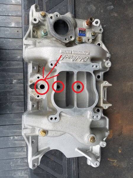

Two holes at the bottom of the plenum beneath the primaries. Purpose?
www.forabodiesonly.com
The first year (1972) 340 engines with cast iron manifolds used FIXED EGR metering orifices connecting the intake plenum with the exhaust xover passage, metering a fixed ammount of EGR ALL THE TIME. In 1973 Mopar and aftermarket manifolds (Edelbrock or "Eddy") used an external EGR regulating valve, the best SOLUTION as suggested is to drill/tap the plenum holes using flush mounted NPT pipe plugs as well as the external EGR metering passageways. Others may have alternate suggestions....Two holes at the bottom of the plenum beneath the primaries. Purpose?
I have heard that there is an advantage to using EGR. Can't remember what it was possibly cooling mixture and suppressing detonation. Sound right?The first year (1972) 340 engines with cast iron manifolds used FIXED EGR metering orifices connecting the intake plenum with the exhaust xover passage, metering a fixed ammount of EGR ALL THE TIME. In 1973 Mopar and aftermarket manifolds (Edelbrock or "Eddy") used an external EGR regulating valve, the best SOLUTION as suggested is to drill/tap the plenum holes using flush mounted NPT pipe plugs as well as the external EGR metering passageways. Others may have alternate suggestions....

EGR was introduced in 1973 nation wide (1972 California) as a way to reduce the Oxides of Nitrogen, or Nox (Nitrogen Dioxide NO2 and Nitric oxide NO) emissions by LOWERING combustion chamber temperature to less than 1500°F by introducing exhaust gas to the incoming fuel charge. What it did was to reduce performance, introducing stumbling/poor low speed performance and reduced fuel mileage. Ignition advance characteristics changed to try to compensate. Reducing detonation....yes....but also performance....I have heard that there is an advantage to using EGR. Can't remember what it was possibly cooling mixture and suppressing detonation. Sound right?
Believe it or not. I had 1 or 2 of them under my intake. They were threaded. I plugged them. My car was a former race only car. I do believe it was for nitrous, lol!Hiding Nitrous .![]()
Makes sense to me. I'll have to tap them to plug them. I always plug off the EGR holes. All manifolds aftermarket that I've had they were already plugged in the plenum. Thanks for the heads up, DaveEGR was introduced in 1973 nation wide (1972 California) as a way to reduce the Oxides of Nitrogen, or Nox (Nitrogen Dioxide NO2 and Nitric oxide NO) emissions by LOWERING combustion chamber temperature to less than 1500°F by introducing exhaust gas to the incoming fuel charge. What it did was to reduce performance, introducing stumbling/poor low speed performance and reduced fuel mileage. Ignition advance characteristics changed to try to compensate. Reducing detonation....yes....but also performance....
