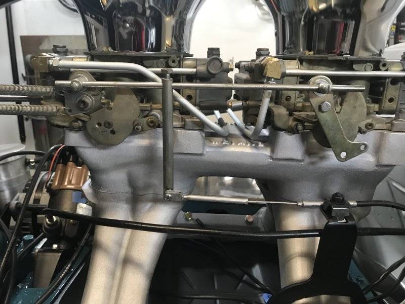

The carbs I have seem to work really well so far but are leaking at a few different areas...
I'd just as soon rebuild them with new kits but in researching it I'm not sure what I need to purchase...
These carbs have the metering blocks installed in the secondary's and the longer fuel feed tubes...
Anyone have any rebuild kit numbers I can use to get everything I need?
If my memory is correct, the list number of those units is 4224. Thats what you need to source a kit from Holley. Renew kit is 37-1537 or trick kit is 37-933. Either is kinda spendy. Maybe contact them or someone like Braswell to see if there is one less expensive to use.
I researched those two kits...then I may also need to add in the extra 4160 metering block and bowl gaskets...
Definitely a little higher than I would have guessed...
Holley has discontinued/deleted hundreds of rebuild kit part numbers and bulked them into universal type kits now. Gives you more than you need for an individual carb. I just ordered (2) 37-1542 kits for my dual quad 4160's and they came with everything needed.
If your pump diaphragms are ok, maybe just order up bowl/metering block/bowl screw/idle screw/pump nozzle/base to main body gaskets/needle and seat units. You can find the numbers for those on their site. Pump diaphragms are expensive since they're the 50cc units. There is a possibility that the two kits contain enough goodies for two carbs since the 4224's were a 2-4 usage on tunnel rams.

I installed the aft metering blocks on mine with the newer-style fuel tubes. Allstate had everything I needed to accomplish this. They will have anything you need for yours.
By the way, your car sounds great!
Thx all...
I ordered two kits from Allstate and they arrived today...
Looks like everything I needed is in the kits...
