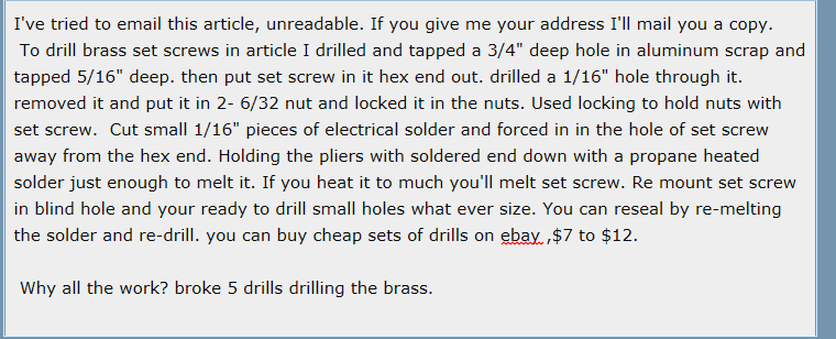

If you decide to go with those carbs on a crossram there's an article in Dec 2015 Hemmings Muscle Machines. The article is Idle Work by Jeff Smith explains how to lean out idle circuit. Helped me to stop fouling plugs while engine warms up. The only thing he had you drill .030 hole through brass set screws, that was a challenge. To long to explain here, if you ever do the 4235,6 carbs on a crossram I can copy article and explain how I drilled holes.

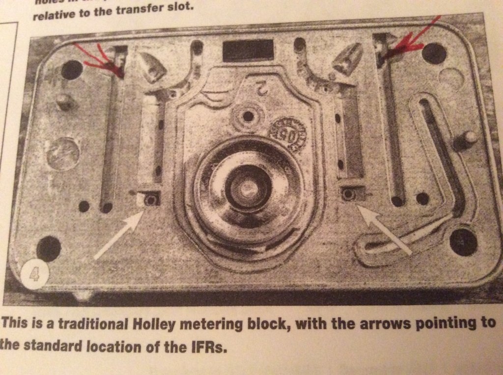

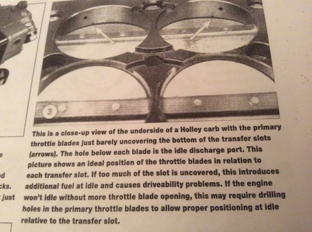

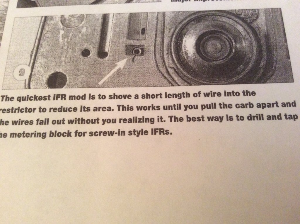

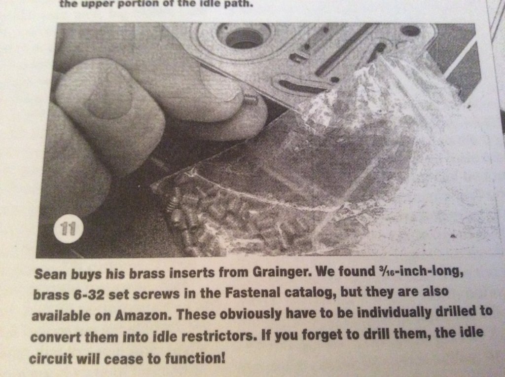

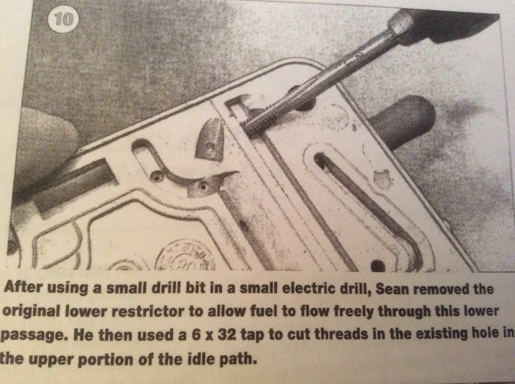

These pictures tell what they did and where they did it. There are two idle feed holes. My carbs had NO bushing in idle feed hole. Thought the guy who owned carbs before me removed them, no. Bought two from Holley no restrictor. Hole was .058 tried wire in hole to make the hole smaller it worked but a pain. Did the mod in pictures with a .030 hole big help, have refine it yet,

other things to work on. The last picture is how I drilled holes in set screws. Broke drills trying to drill brass.
Edit: In description how to drill holes should read "locking pliers".

The red arrows show where drilled set screws go after tapping holes with 6/32 tap.

Gladly mail you article after that your on your own. It's easy except the pain of drilling and soldering the set screws. Once there soldered they drill like nothing. In that description wasn't clear I hold the set screws that are locked in two nuts with locking pliers while soldering. Bought a set of tapes on ebay less than $15 and mini drills were a little less.
