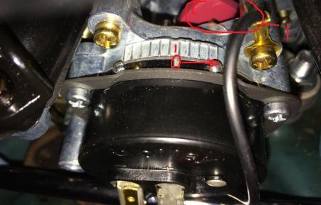

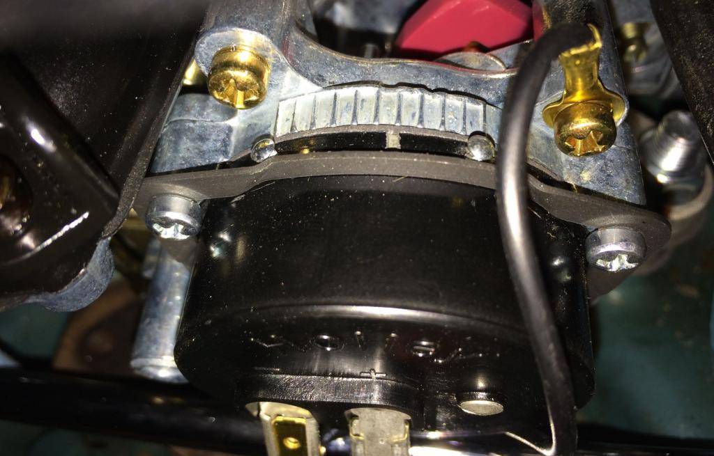

Here is a photo of mine.
The silver screws are the ones you loosen (and the one on the bottom you can't see)
You can see the mark on the cap and the marks on the carb body. I believe clock wise makes the choke come off at a lower temp, counter clockwise makes it stay on longer.
Only adjust the choke spring when the choke is engaged! Very easy to setup, unless you need to adjust the fast idle screw, that can be a pain. Might wanna invest in a Holley book, tons of useful info if you don't have much experience.
Turn the cap clockwise to stay on longer, counter-clockwise to come off sooner.
