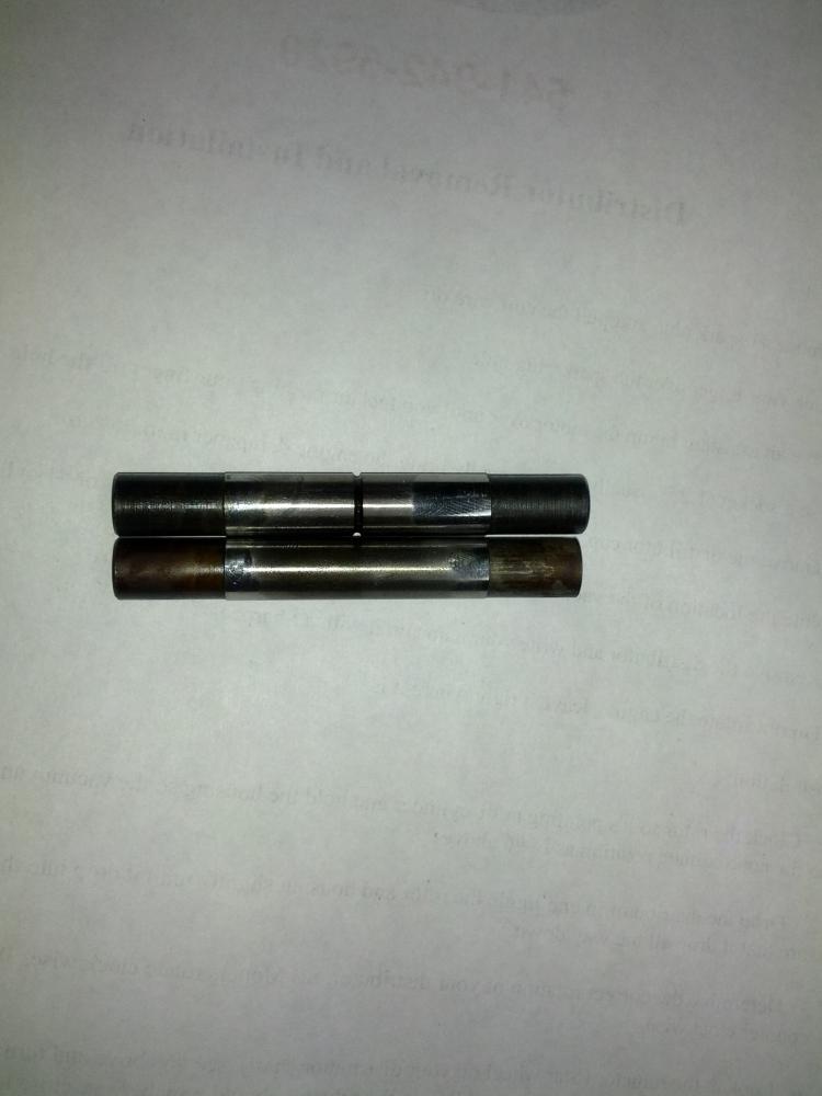

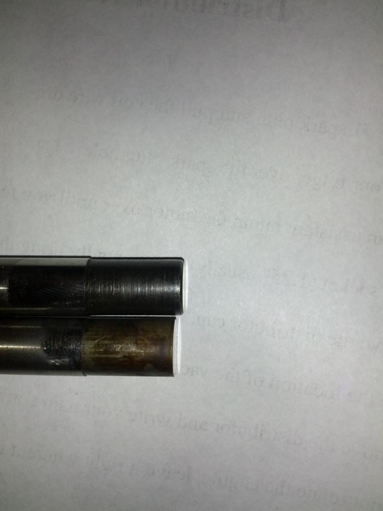

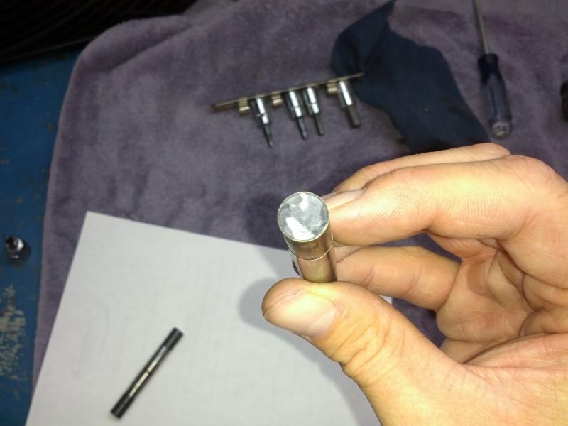

Greg I thought of that too but still had a no start condition after complete cool down. I pulled the fuel pump and rod and found this... It looks like I'm another victim of the cam eating the pushrod. I'm not sure if the pushrod that was installed was an aftermarket one or an original but I pulled one off the old 400 in my backyard and they look different. The one from the 400 has an engraved line that goes all the way around in the middle of the pushrod. The one that was eaten by the cam doesn't.
So my next question is can I just install this other pushrod I have and be done with it? Is there anything else I should do like change oil or just change the filter? It figures something like this would happen now since I just changed the oil about a two months ago with Amsoil Z-ROD which isn't exactly cheap. I also took apart my Holley fuel pump to inspect everything and all the seals look good to me, when I put it back together is there anything special I need to do?

That pump pushrod didn't wear out overnight. But........
If they are hardened like I suspect they are, it may be a case where it was fine for thousands of miles with almost ZERO wear, THEN once it broke through the .010 hardened outer layer, the softer inside wore away quickly.
I have seen this before. Your different styles could have still been the result of different vendors to Chrysler. They could both be factory issue Chrysler parts even though appearance differs.
I hope the one I've got with the line in the middle is OEM as I've heard the Mopar Performance ones are junk. I'm hoping, after confirmation on here, that I can just throw this other push rod in and change the oil and filter and be done with it. I think you maybe right Greg since the car was running great all the way to the car show then all the sudden as I was going to park it just quit. Either way, the pump looked good and it seems to be doing it's job when I depress the lever it'll try to suck my finger through the "in" port.
Can anyone verify that the pushrod I have with the machined groove in the middle is not a Mopar Performance push rod. Hopefully not so I can throw it in my engine, change the oil and get her running again.
