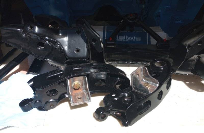

After searching high and low for lower control arms with the factory sway bar tabs and never finding them. Then I ordered a pair of preformed weld on sway bar tabs many months ago with no estimated delivery date in sight. I decided to fabricobble a pair as seen below.
I used .250" angle iron with gussets. Drilled for and installed with .50"x 1.00" Grade 8 bolts. Now I just have to remove them and powered coat to match.
If the ones I ordered ever do come in, I can easily remove these and weld on the new ones... but I'll probably just keep these on!
Happy Wrenching!
