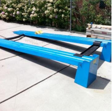

I also have low ceiling... I use a Kiwi lift
