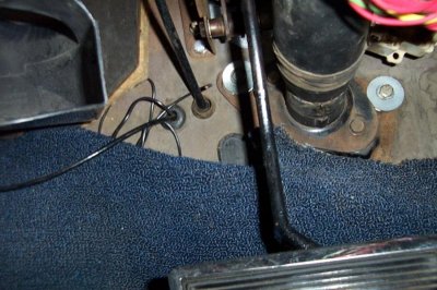

Can ANYBODY describe or have pics of where the hood release cable goes through the firewall on a 73 Charger??
It is the last think I need to do before putting the carpet back in and I do not see a hole for it to come through.
Heres a 72. Should be the same for 73. To the left of the speedo cable.

Thanks, that is a nice Christmas present.
