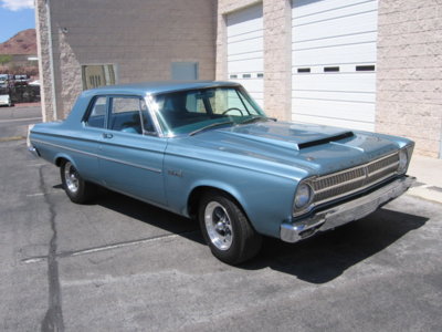

Looking for input I have a 65 belvedere and I'm wanting to do the hood scoop and an air pan just wondered if anyone has any experience with if this picked there car up thanks!

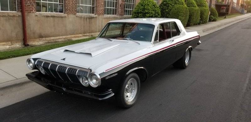

First off your car looks great , and this is not a put down but I am 70 years old and seeing the real hood scoops that came on the factory cars , they had a stud and a spacer in the middle of the scoop to hold it open in the middle . In other words if a straight edge was placed across the top of your scoop at the front edge and the middle was spaced upward till both of the sides were level then that was how the factory scoop came on the cars . it would open it up and allow more air in . I just see so many scoops like this not done this way . P.S. had one of the factory scoops on one of my street cars along time ago , Again your car look great and thanks for the pic .
