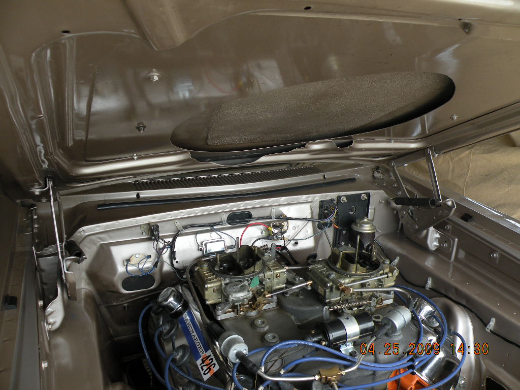

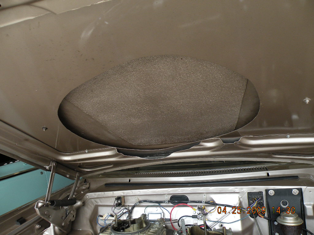

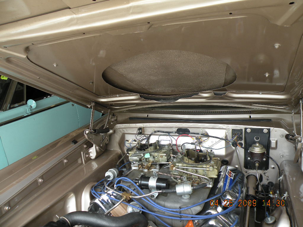

heres a few pictures of my a990 hemi coronet for comparison

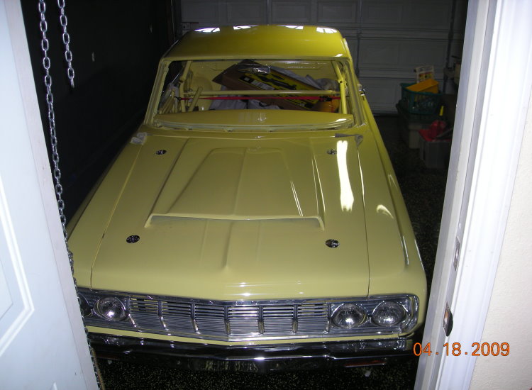

Here is mine. The channels have been filled like Redpolara describes above.

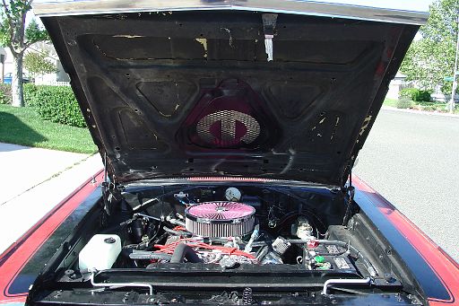

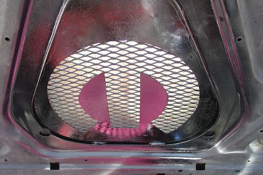

I did not cut any of my hood braces and just opened the center for air flow. I welded a piece of 1/8 inch grate to the top of the hood to restore some strength. I liked this better than cutting out all of the hood in the middle of the center brace.
I have seen others cut out the hood the size of the scoop and not do anything to reinforce the hood.

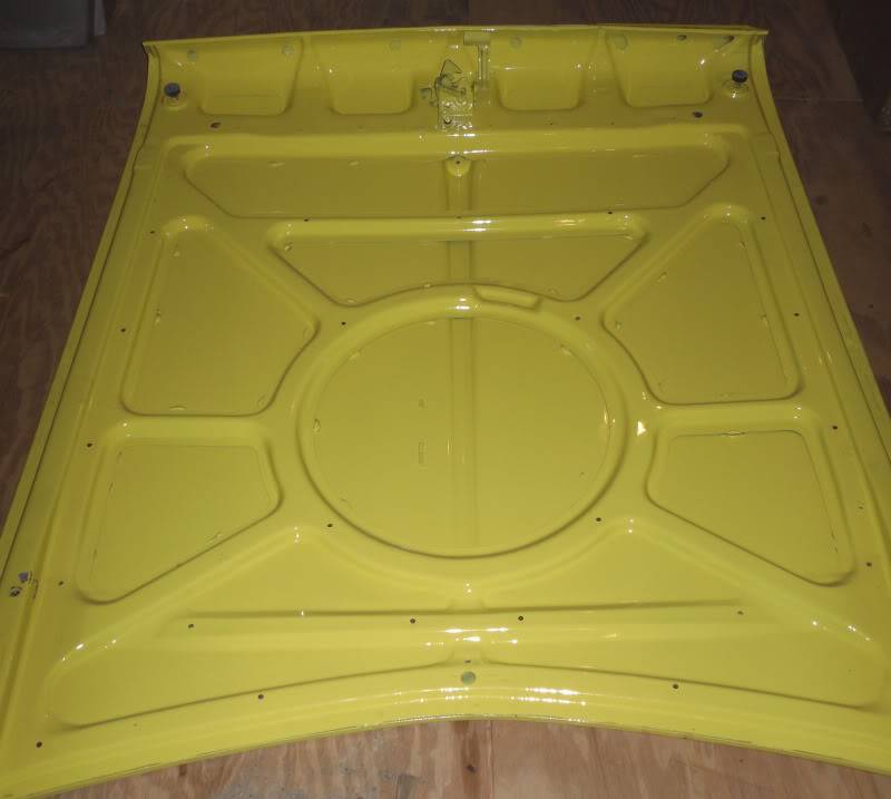

I'm struggling with this surgery too. Next week my glass hood is coming off and I am going to reinstall this OEM hood.

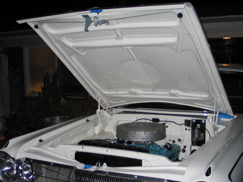

The center circle defined on this hood would be perfect - except the distance from the back edge of the hood to the edge of the "natural" circle is 10.5" and this is exactly the distance I will need to clear my 14" air cleaner at the rear. I will either need to cut into the circular channel that surrounds the center flat spot to open it up - or go with a smaller diameter air cleaner. If I do cut into the channel / frame some I guess I will also need to butt weld in a piece all around it to maintain the gap between the frame and the top sheet metal?
If you mean me ? I don't plan to fill the channels with anything. Don't see any need or benefit from filling them. The sheet metal is about 1/4" off of the channels anyway and the two sections are just stuck together with putty. What I do plan is to weld the top skin to the channel at the circular cut - but it will need to be boxed to maintain the 1/4" gap or else the skin will be pulled down.
