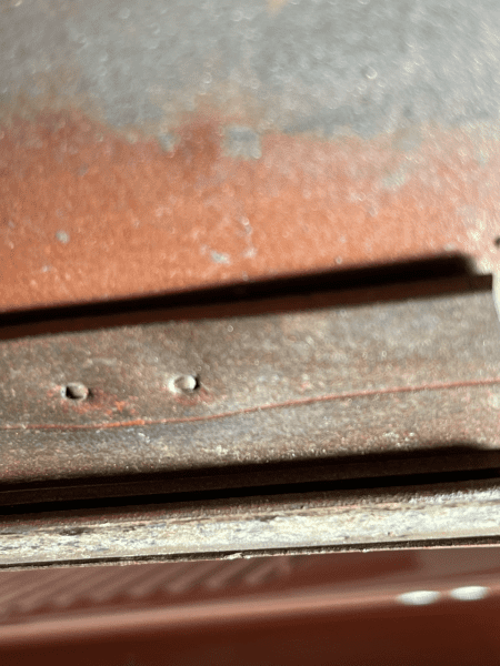

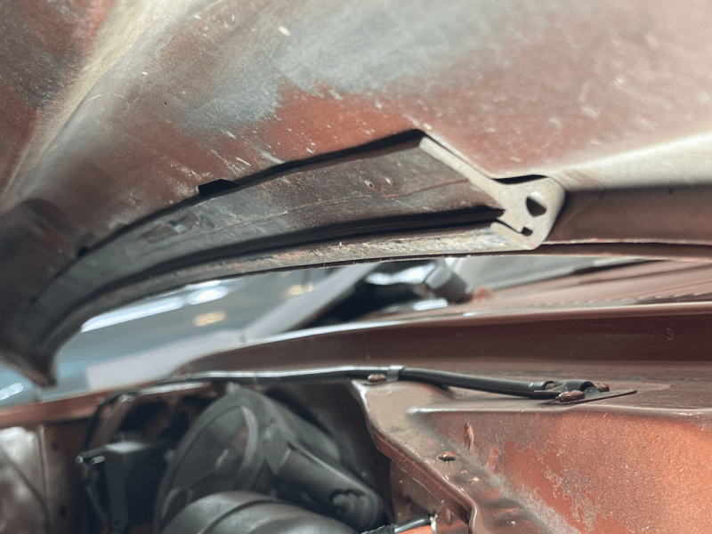

Mine is the original I would say. Hopefully these help with the reproduction.

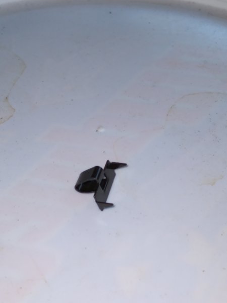

Where are the clips? Those little round buttons? The clips they sent don't look at all like that.
The little "buttons" are the end of the clip staples bent over. Sad that the repro mfg can't install them and expects you to locate position and do same.

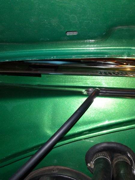

Clips in these slots near top of photo? Then punch those tips through the seal and bend them over?
Do they have anything on the seal to locate where the pointy parts of the clips come through like holes?
Yes, I would say that's the slots for the clips.
