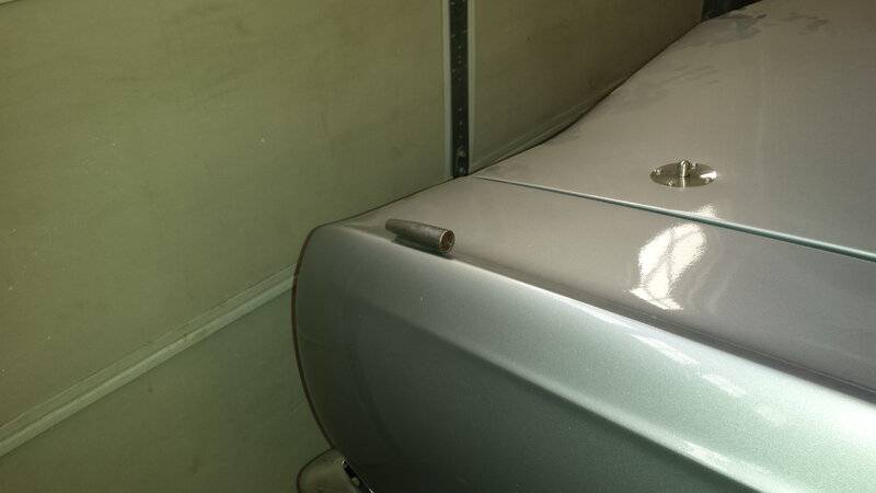

On a 70 satellite they are on the hood. GTX amd RR have them in the rear of the hood. They bolt on. The wires run under the hood pad to the rear of the hood. Then they connect at the firewall to the front harness. They do not connect at the front blinker like the fender mounted ones.

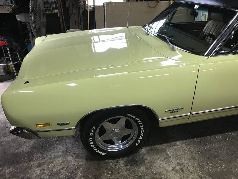

I found repros online, I was wondering but I don’t think I’ll add them since Id have to make a hole in the hood. If I get the roadrunner or gtx bulge hood I’ll add those since it has the cut outs
You won't see the fender mounted lights on a 1970 road runner or GTX since their option was in the bulge hood, but they were optional on Belvedere, Satellite and Sport Satellite for that year according to the Plymouth Data Book for salesmen. If you do get the road runner hood, you may as well get those lights too, but make sure you get the proper insert since the holes were blocked off if the light package wasn't ordered.
