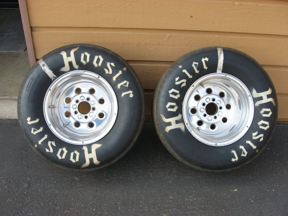

I run 30 x 9 x 15 Hoosier Radial slicks on my car and they work great!! :headbang: I recently bought a pair of Hoosier bias-plys and I hate them. I'm just giving you my two cents.

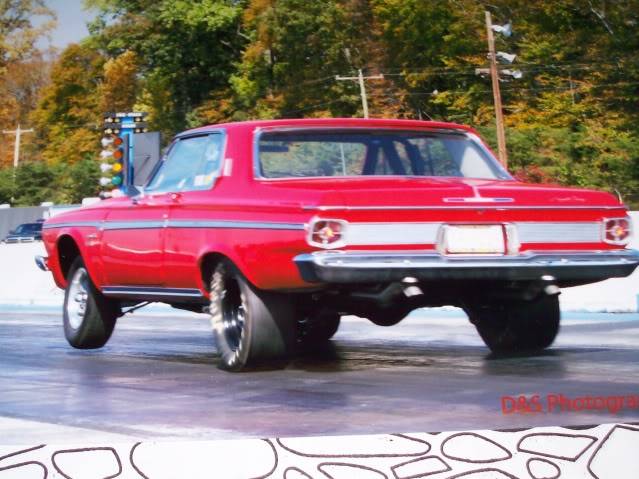

I use the Hoosier radial slick also. I use the 30 x 9 tires and I drive them on the street also. Been on my car over 2 years on the street and made about 20 to 30 track passes also. They work great on my 63. Ron
