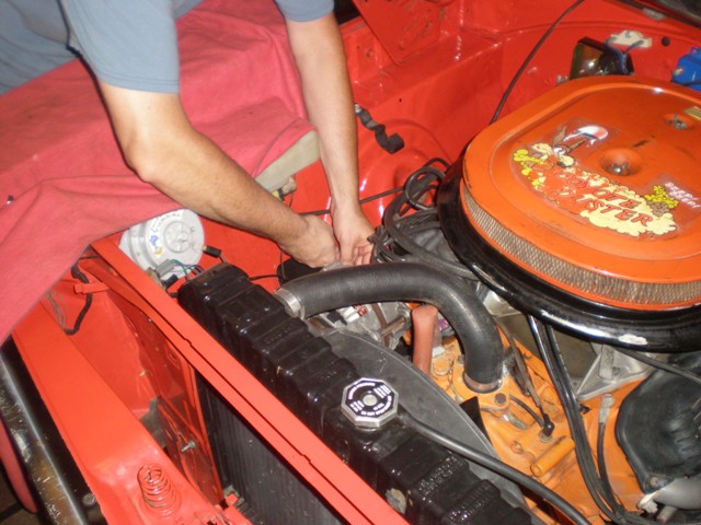

No bracket it just screws into a hole next to the horn, I don't have a pic at the moment for you though. Don't forget to make sure it can ground, just putting the screw in should knock off enough paint for it to ground.
sorry best picture i could find but it bolt right to the core support

Thanks Guy's...I did notice Your horns have only 1 spade terminal?
so I guess they are power and frame grounded?
Oz cars have 2-4 terminals...so I'm guessing I can't use the one's I have?
