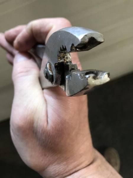

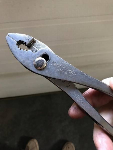

I remember the first time I tried to remove those spring clamps, I was probably 13-14yrs old and my grandfather just stood there watching me struggle with regular pliers. After a while I was so frustrated he walks over and tells me to use the proper tool for the job and hands me an old set of Craftsman corbin clamp pliers....had the clamps off in a few seconds! I still have my grandfathers old pliers and use them regularly on the old mopars!

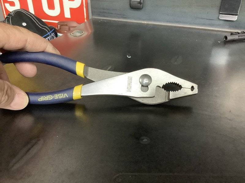

One side angles the clamp forward, the other side angles it rearward. There are also notches on the front tip. They are easy to use and won’t mar the finish on the clamps.
I have the same pliers that my Dad gave me.
