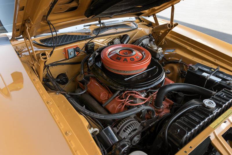

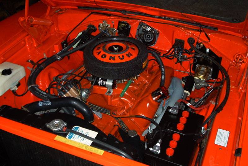

I assume it should look like this? This is a 71 Super Bee
radiator inlet on passenger side
Well, color me stupid!
I always thought the coolant flowed out of the top of the radiator and into the 'stat and the inlet was in the bottom. Well, there is my lesson for the day! Lol
That looks about right. I did however have some flex hoses from when I first got the car. They fit just great.
