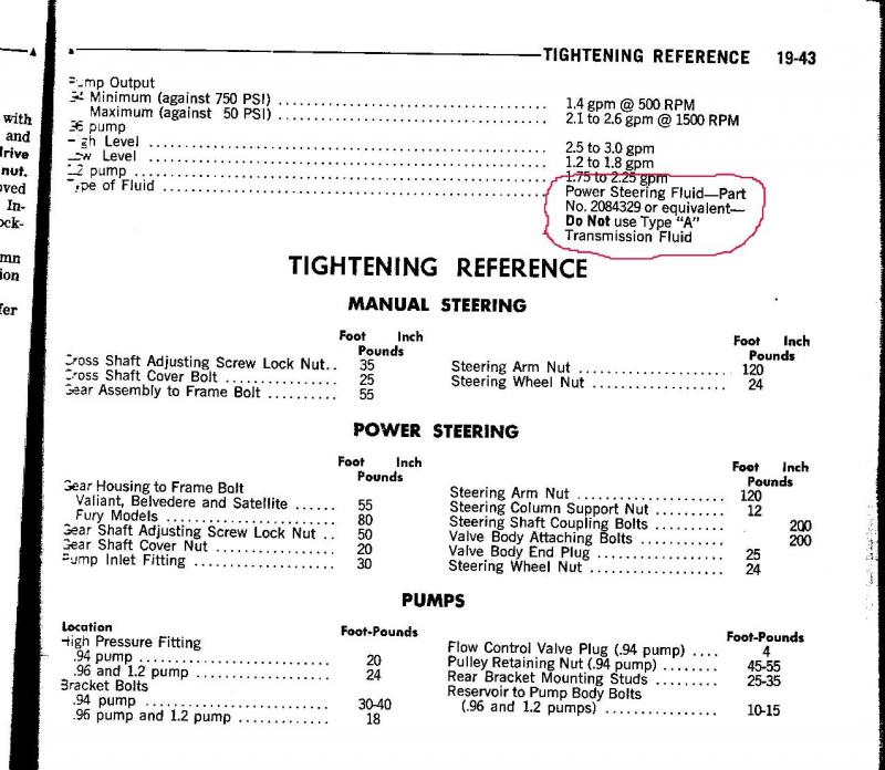

What is the recommended fluid? Up until about 10 or 15 years ago I didn't know it was even made. Maybe it will tell me in my service manual. If I get a chance today I will take a look. In the end I'm sure it will get the cooler, but I can't resist checking some different fluids for the fun of it.
From the manual.
Well before I could do any thing, my fuel pump quit. so I'll have to fix that before any testing. I'll take 62MAX's advice and get a better power steering pump fluid. I see a lot of people are using red line PS fluid.
