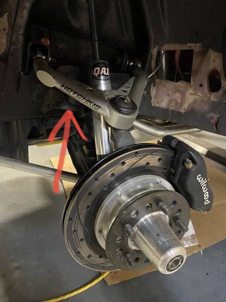

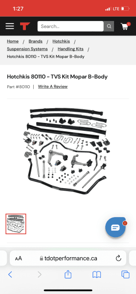

Just bought a 68 satellite and the previous owner had installed the hotchkis suspension kit 80110 (pic of kit attached)
When I lifted up the car on my lift, I noticed the upper ball joint is basically the stop (and has ripped the boot on both sides likely because of this). I double checked and the upper stop looks to be new and the one supplied in the kit…
Am I missing something or would a taller upper stop fix this problem… I attached a couple pics. Thanks for any help on this.
