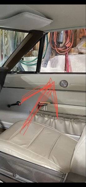

I bought from Classic and when installed you get very visible bumps from the install-clips.
I had to fix this by creating a small "Shovel" and dig out some foam under the clips.
In some restoration pics i see these bumps.
