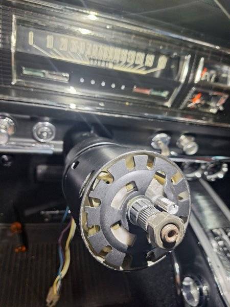

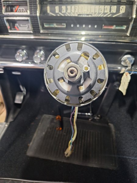

I need to get to the signal awitch wiring but metal plate is in the way. This tilt mechanism is from a gm vehicle that was used for a tilt column conversion on my coronet some years ago. Anyone know how to remove it??
Push it down and remove the wire retainer clip/snap ring at the base of the big splines.

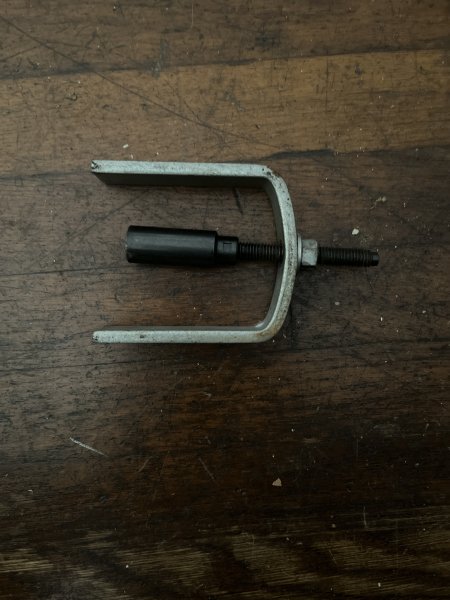

Get yourself one of these tools, I can’t remember name. It will push in on the plate allowing you to remote retainer.
