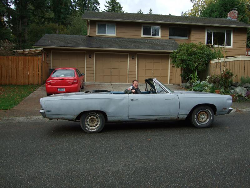

Got a picture?
yea but dont know how to post it
