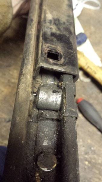

I took my 6 way seat base apart. And I'm glad i did. It was missing a part from the factory it had metal to metal contact and would not have worked correctly just by cleaning it. So after disassembly, I greased and painted it. And works so good that it's as good as new or better.

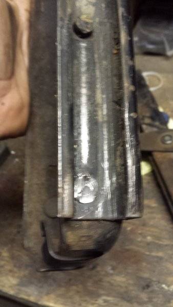

I pulled mine apart. You have to drill out the front rivet to pull apart and just weld it back.
