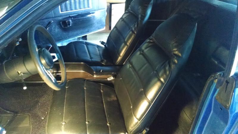

how do i get the non- ac heater box out of my 73 roadrunner ???

best to remove passenger front seat & console. Unhook cables & electric wires to box...remove heater hoses from core, remove 4 nuts holding box to firewall.
I would suggest a factory service manual if you are gonna be taking things apart on these cars
I would also remove the glove box so you have some space to slide it back from the fire wall.
